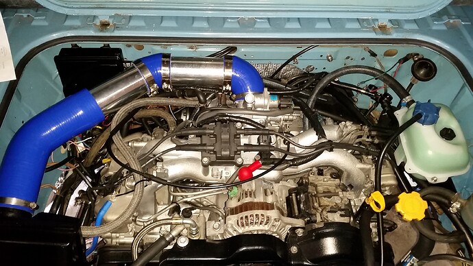

Hi Gaetan,
The original air box does actually fit - just not in the factory Subaru location.
Mine is tucked into the left back corner and I used a bracket that I salvaged from the Subie wreck to keep it in place. Works great but I still like the RMW version better.

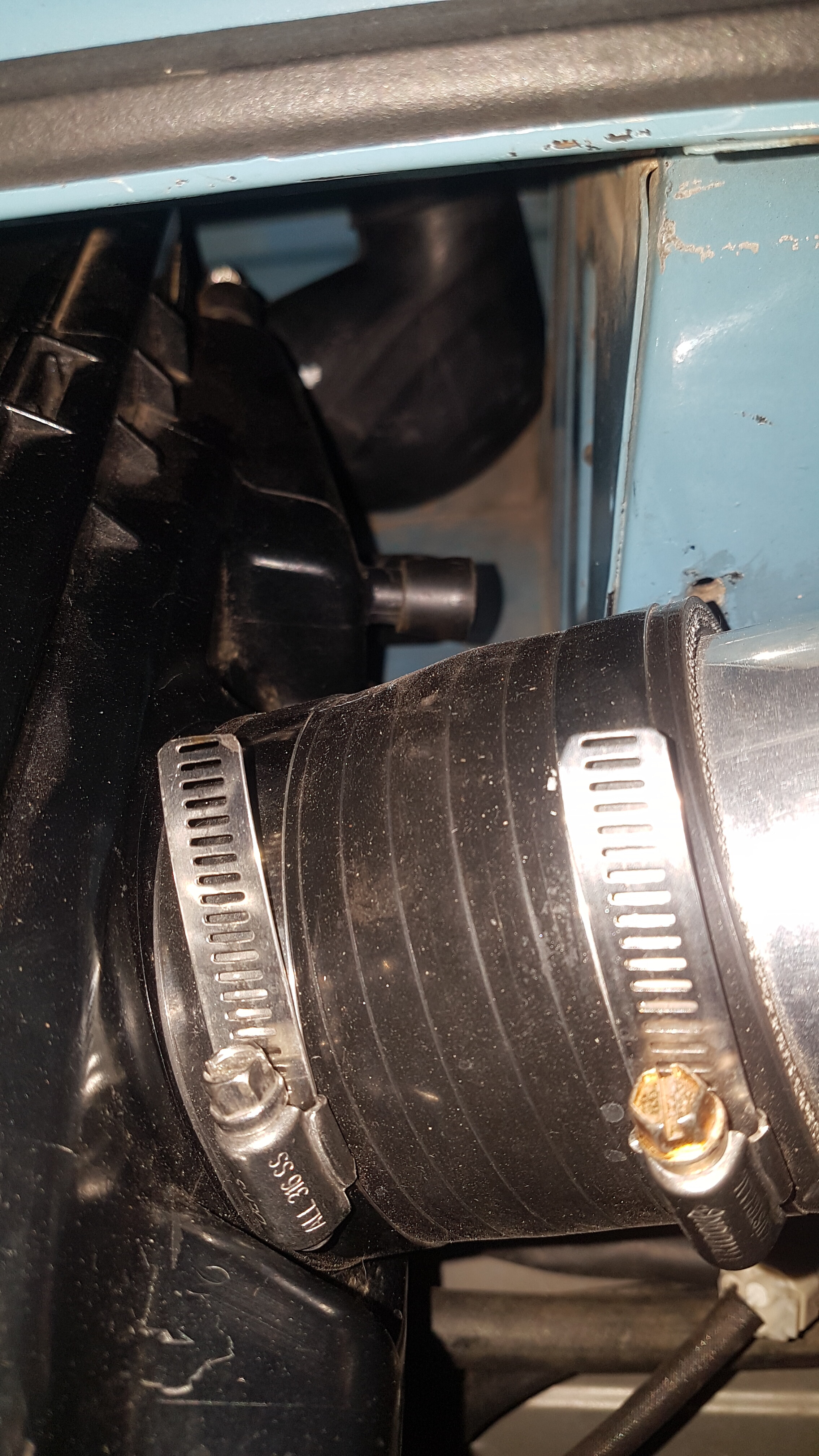

Hi Scott,
I finally got round to get a Liberty air filter box and have a bug trip coming up. Wondering if you have any more pics of your bracket and how it connects to the snorkel?
Also what did you do to close the hole at the bottom of the Subaru air box?
Hi Gaetan,
The air-box sits there happily so my small bracket which I pulled off the donor car just keeps it in place.
There was no hole in my air-box other than for the throttle body and rocker cover vents - not sure which model you have but mine was a 2000 model Subaru (same as the engine) but they seem the same through to the end of the 2003 models.
Here are the best photos I can take with the engine bay all in place.
