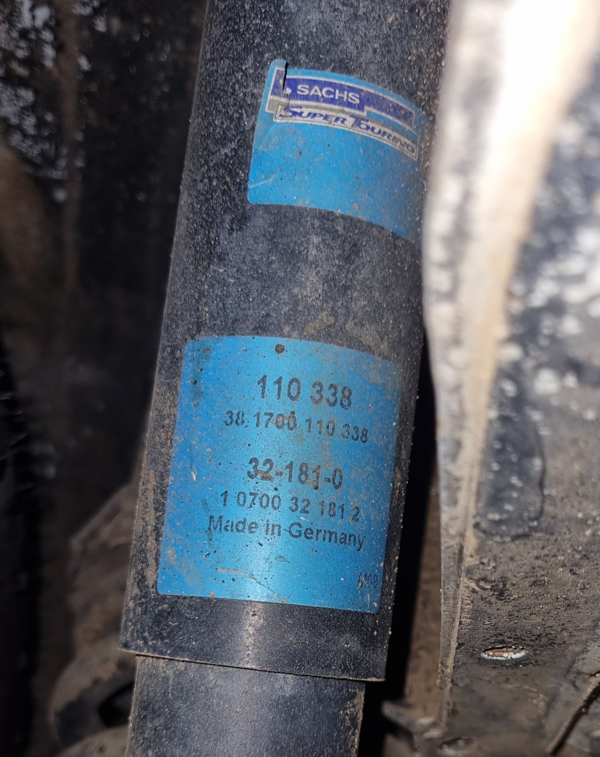

Guys. Would these be original?
Car has 210k on the clock.
Sags a bit in the back morso on the ds. Possibly because the cubpoards and water tank are there.
Original were BOGE shocks. Sachs are aftermarket ones, so definitely not 200’ks old.
Sag is due to weight distribution and and springs. They will sag over time too. You may can use shims to level your van as even if you buy new ones, it may sag on one end/side
Cheers Arne
Thanks Arne.
I’ve got some shim matl but would also want to get some swenke all round. Maybe keep the shocks and a shim
