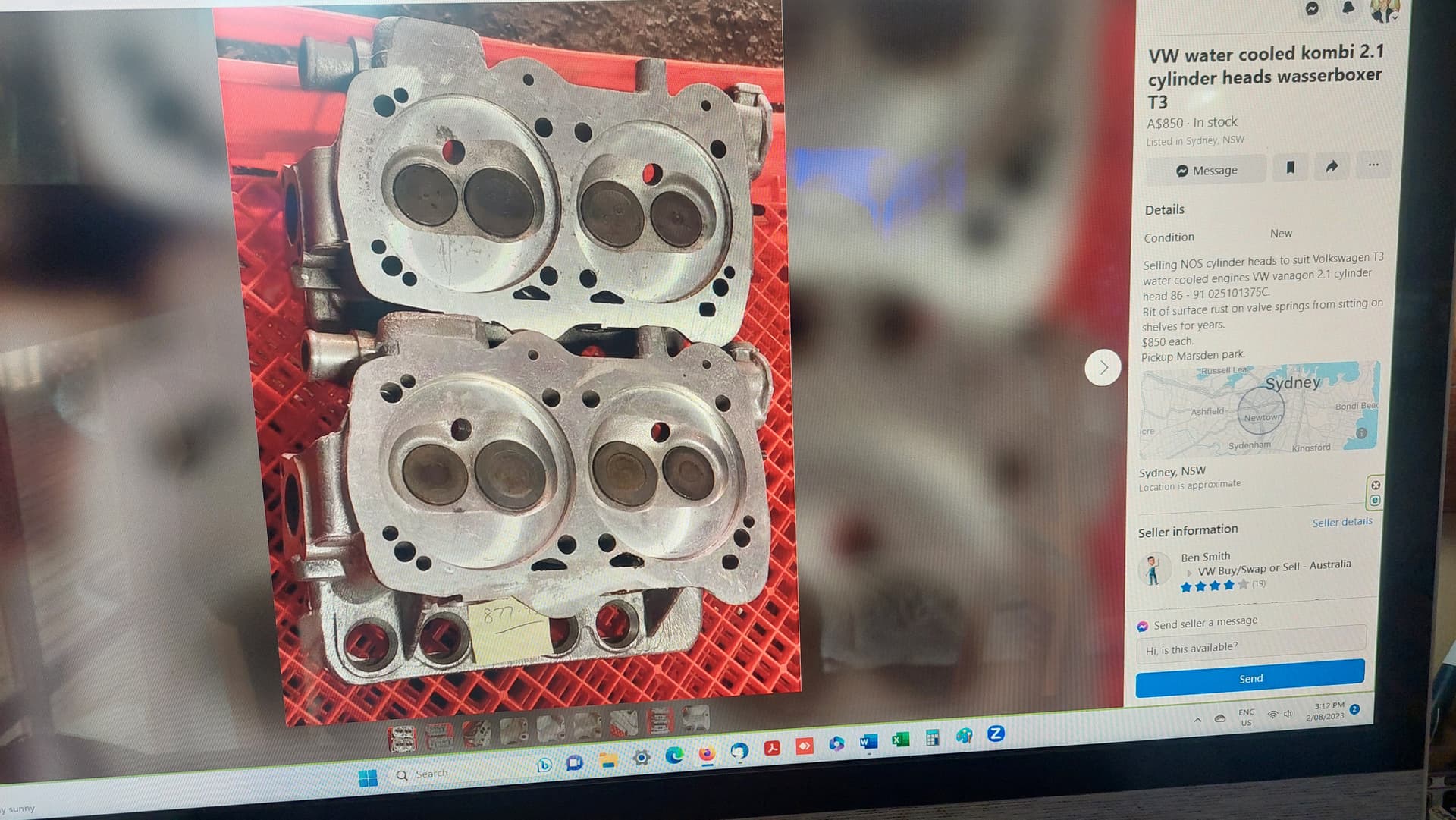

It seems there is a set of factory watercooled heads for a 2.1 MV for sale in Sydney for $850.
Havent seen that for a long time…
hey Scott, is that on facbook? And is that Ben that has (had??) a syncro?
If you could make contact for me, I’d certainly be keen. I need to buy a set of heads for my engine.

This is a different Ben…Ben Croft had a nice syncro but sold it a couple of years ago now I think.
I asked this Ben Smith fella for a contact number.
I will let you know if he replies.
He got back to me and he seems to be up your way in Brizvegas area.
He gave me this contact: Call Vic 0428 145 889
I saw on another one of his adds that he has reconditioned heads for $500 that look really nice in photos anyway.
Hope it works out.
Thanks Scott, really appreciate it. Gave him a call, and he still has them!

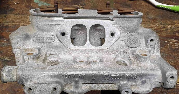

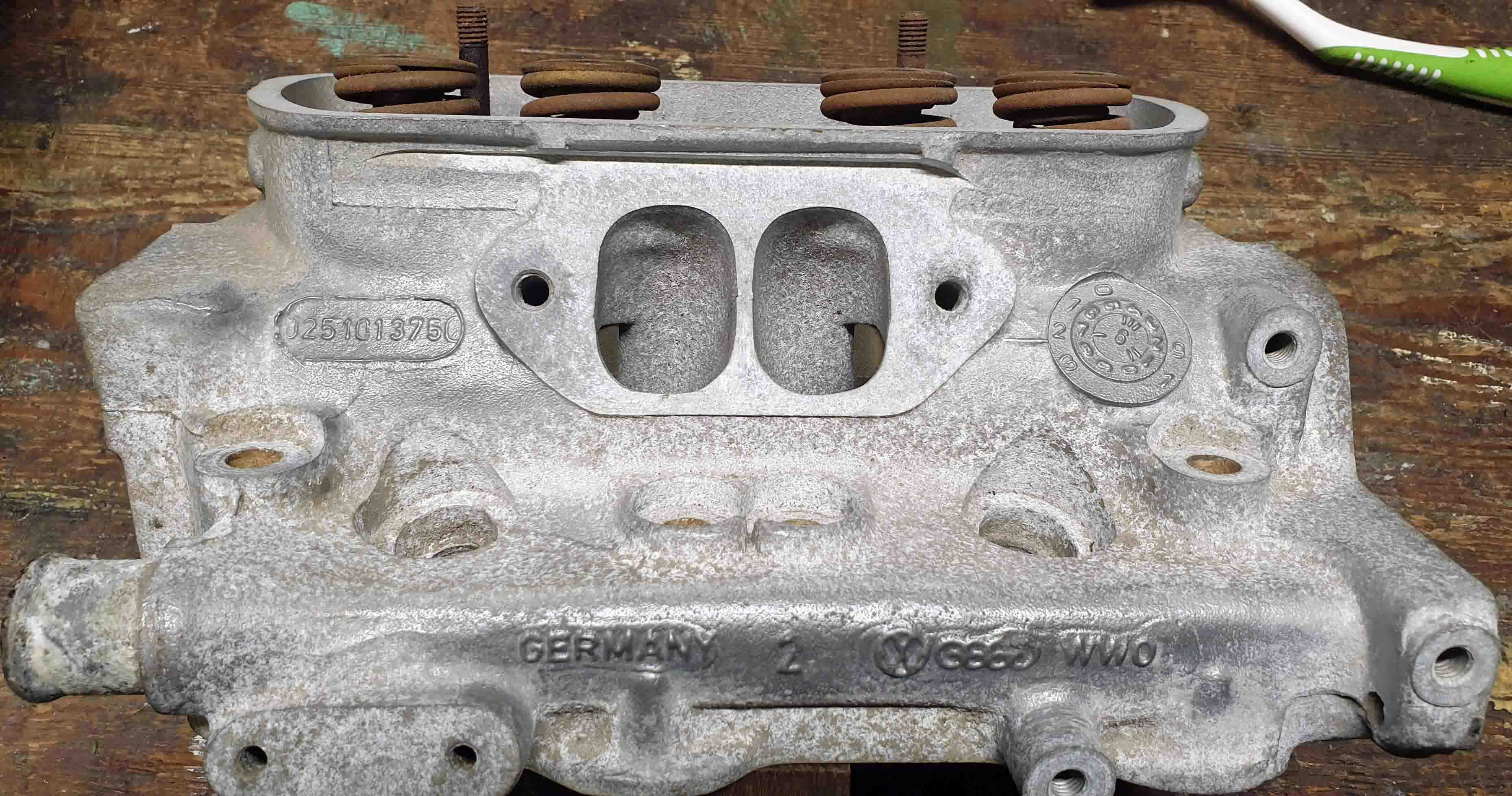

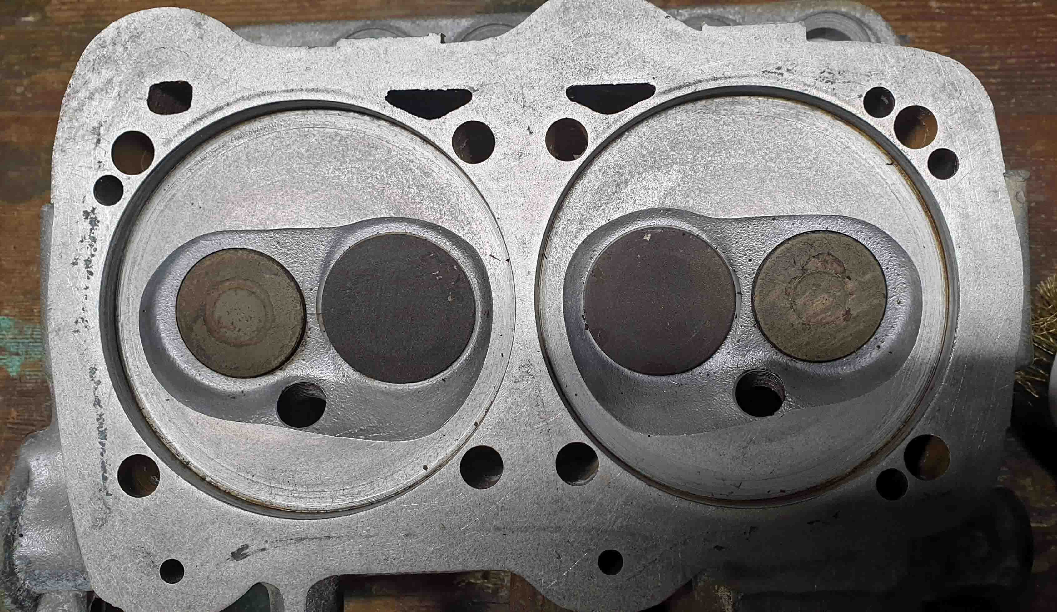

Just for the hell of it, here’s pics of one of the heads, take a look and see what you think. Only issue I can visually see is the very lightest of etching into the seal area at the left end. No similar etching in the other head.
So from an untrained eye, they look ok, still wondering why the previous owner had cause to replace them. Will never know the answer.

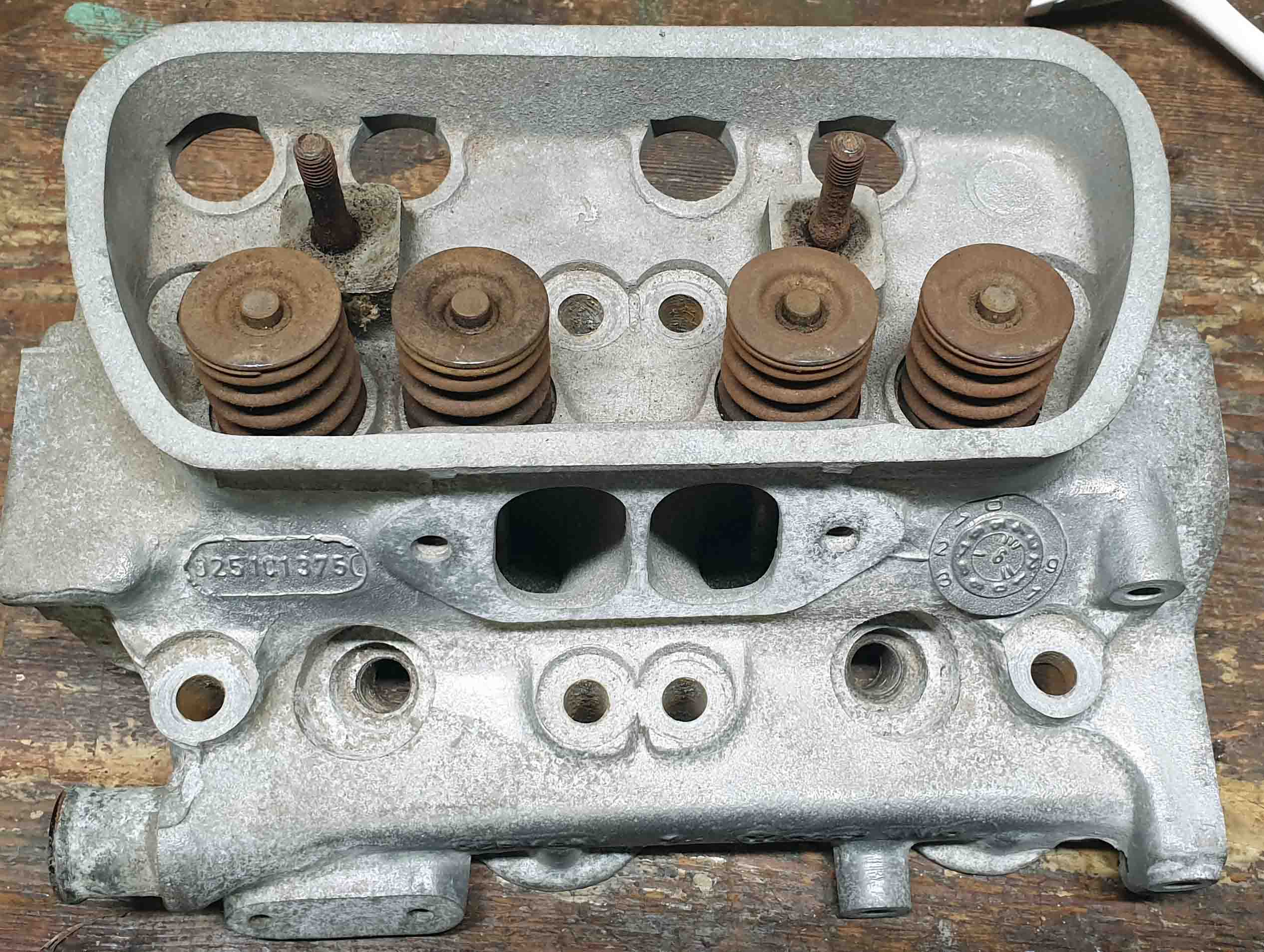

Here’s a pair on TheSamba for comparison:
I would be hanging onto them Ken, I agree they do not show any visible signs of cracking. I do have the die crack testing gear at work, but not much help to you I guess. The etching you mention looks to be in the inside edge of the seal, so would not affect the seal doing its job.
The corrosion on the outside does not look great, particularly on the valve springs. This can lead to them cracking eventually. The coolant pipe connection also looks corroded. They may have had non OEM coolant at some stage.
I think they are worth hanging onto, if you ever crack a head, these will get your van running again if you did not want to do a more extensive rebuild.
It you were doing a full rebuild on an engine though, I would use new heads.
As you said, will never know why they were removed, but if a head stud let go, or the gasket failed you would need to remove the heads, and mostly likely would just put new on rather than re-build.
The pics on the Samba, hard to tell, but I’d guess they have cracks.
The casting on those heads looks great. Cant see any cracks in them and almost zero corrosion!
Not sure if you can clean up the valves but VW valves were way better than AMC heads supplied valves.
Agree with Richard - dont throw them out!
Thanks Richard and Scott for both encouraging replies … looks like they are keepers then eh.
Confirm the left hand end face “etching” does in no way present as “pitting”.
The valves and springs as shown present as they did when I first came into ownership quite a few years ago, since then have been packaged and stored away dry ever since. Ta guys and I value your inputs.
