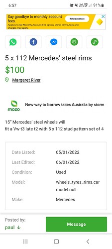

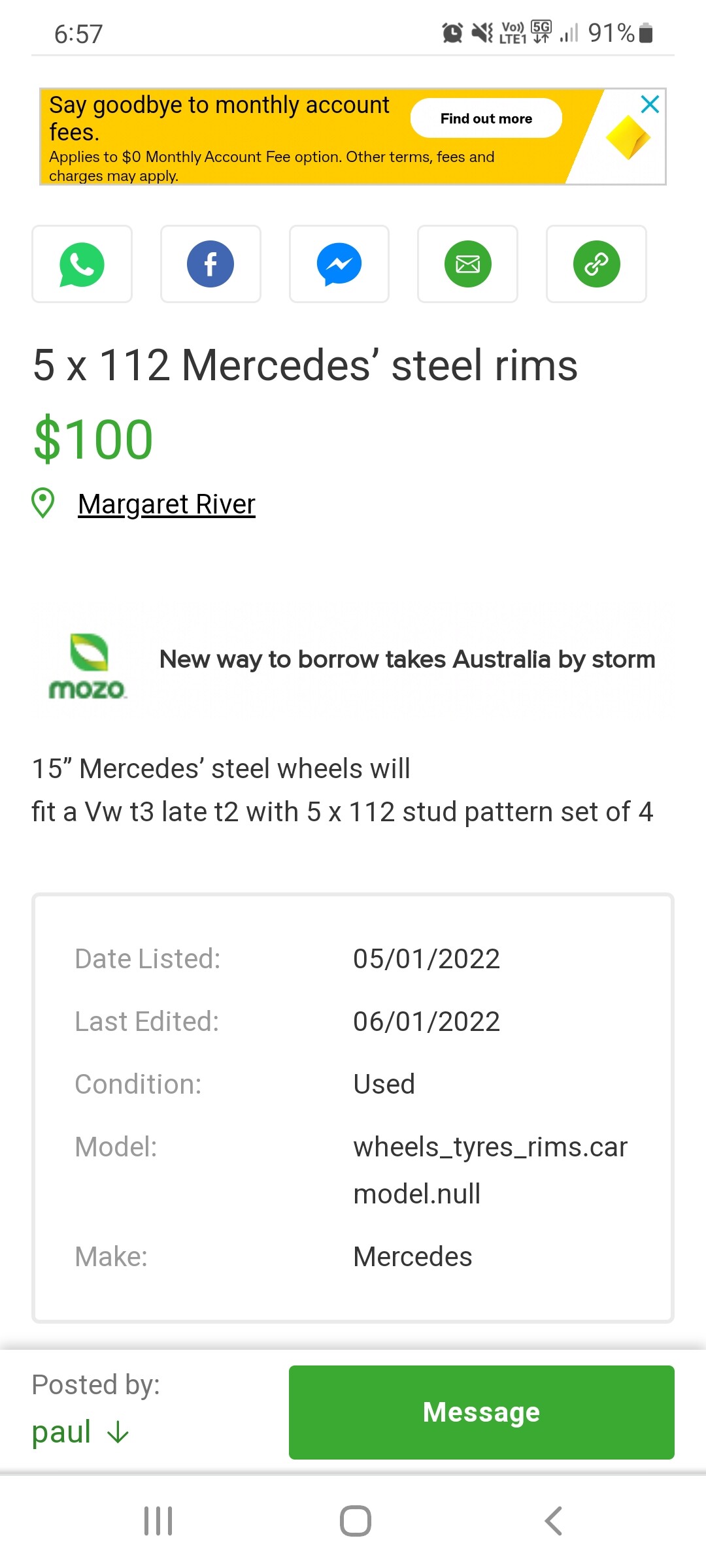

Harold. Not sure if these are still available
Cheers, Neil. That was a screen shot but I don’t see an address or link to that ad. Appreciate the help though. Is your 2.1 Syncro a camper or a lighter van? It’s just that when Phil mentioned a heavy camper that pretty much describes my van. Especially when we are going away for a trip. And there is a site I’ve used “syncro.org” that runs an article on tyres and wheels and the 16" definitely mentions gear changing to compensate for the wheel size. But if I can connect with this Margaret River set of 15" I’d definitely look at that. Thanks again.
Sorry Harold. That is on gumtree.
