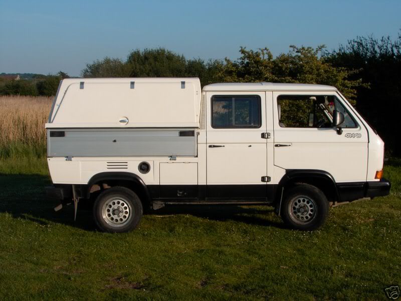

alloy drop sides
hi guys n gals, are there any single cab or double cab syncros in Oz wearing the alloy sides / gates, also any with canopys?
see pic

Jon,
Some information on the vehicle would be of interest.  Presumably this is yours?  Where did the sides and canopy come from?  Presumably aftermarket?
Les

Hi Jon
Some Tristars were originally depicted with alloy sides, however, the only Tristar Syncro in Australia has standard dropsides. That said, Hart has found some of the last alloy dropsides in Europe and is sending them out to Australia for fitting (during the resto I assume).
Nice looking DOKA - can you tell us a bit more about it - year built, Deluxe/Non-Deluxe. I notice you have Caravelle style mirrors on it

Les,
That picture looks to be from Patrik's website in Sweden. From what I can see in the photo, this Doka has aftermarket  copies of the Tristar alloy gates. The factory gates have latches similar to the steel gates except the sides are finished in black instead of cadmium plated. I have a set of the Tristar gates which will be installed on my 89 Syncro 16 Doka. The a Swedish 'Vindic' brand canopy. It attaches next to the cab via a roll bar with steel grid to protect the back window from shifting cargo. The rear corners are supported by two steel stanchions. This permits all three sides of the canopy to open. Have one in front of my house now also awaiting installation.
Regards,
BenT

Ben,
That sheds some light on it.  This suggests that there was a fair aftermarket in Europe .
Les

Hi Kombijon,
Yes, I bought a set of alloy dropsides, they are in transit and should arrive in SYD in September, I believe that they are VW parts{fingers crossed]
And they are to go on my DOKA Tristar   Hartmut Kiehn
