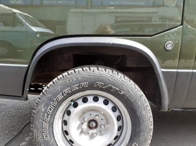

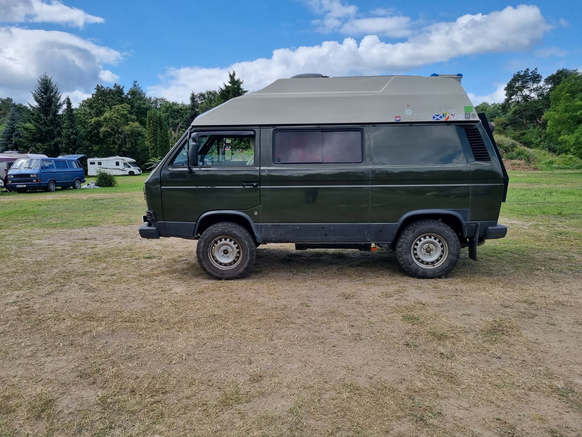

The only photo of the front wheel arch is this:
The rear part was bent a little bit out. Since this photo, the van was further lifted, and the 225/75R 16 tyres fitted.

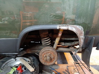

I modified the rear wheel arch by lengthening the arch backwards:
Only then I fitted the 16” trailing arms which are 2.5 cm longer, thus moving the hub backwards.

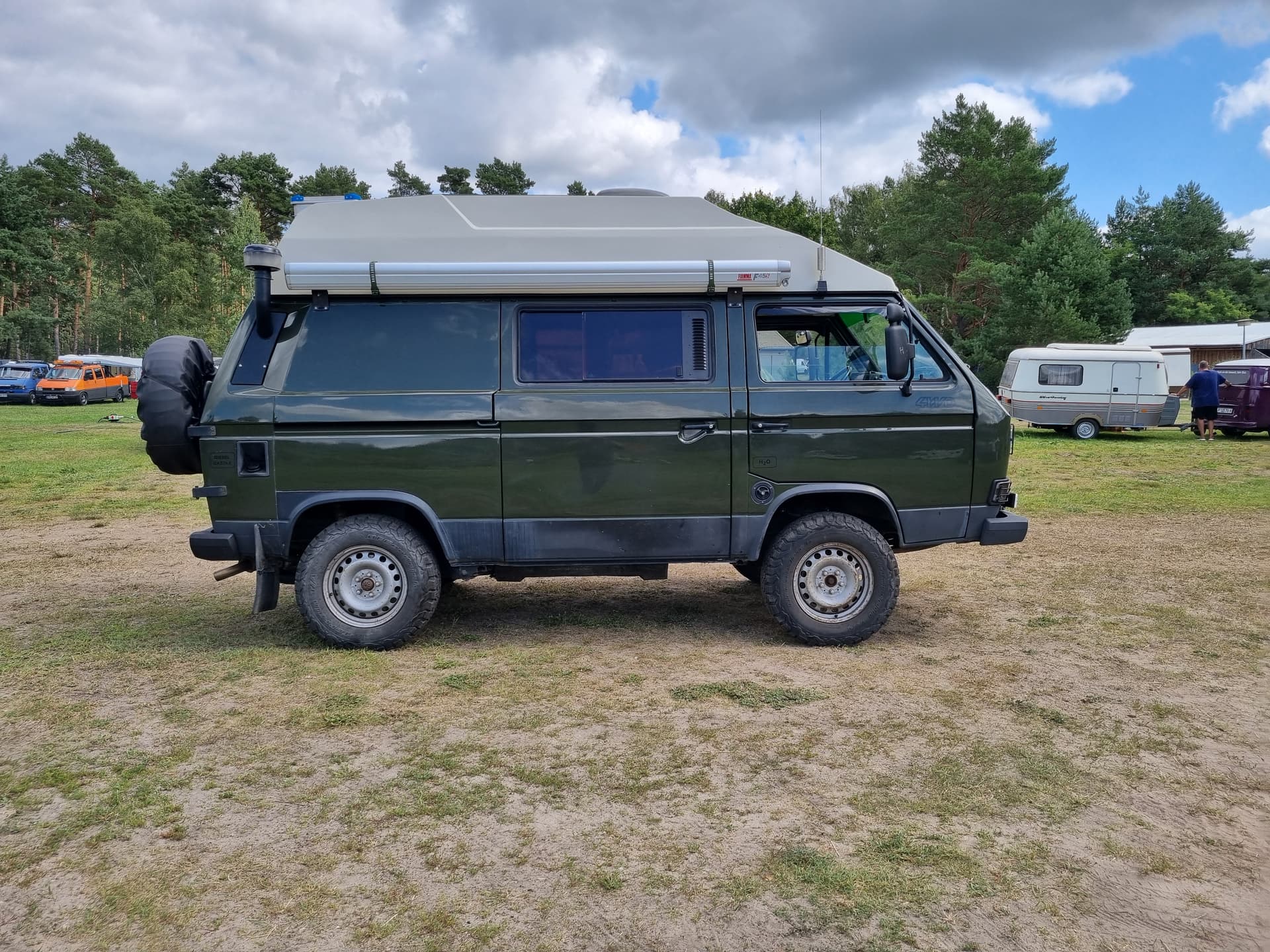

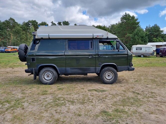

This is how it looks now with the 225/75R16 BFG K02 tyres. Photos taken last summer:
I plan to further lift the suspension during the winter…
