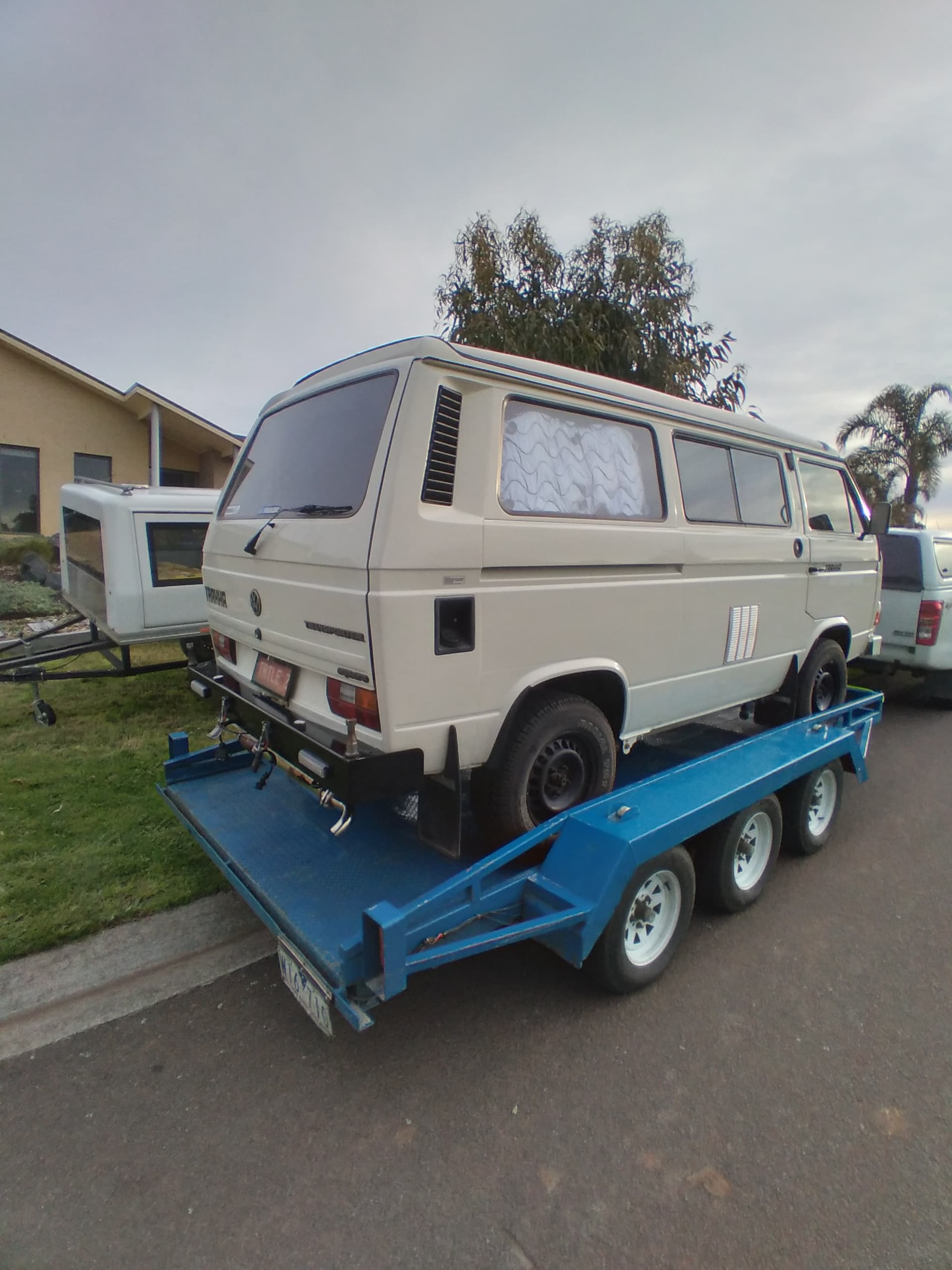

Change gearing yes,no
So question for suby converted syncronaughts
Change final drive to suit seeibg as gearbox is getting fixed thoughts advice be appreciated
Cheers andy
