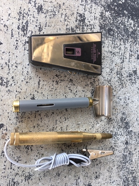

Found these going through an old set of tools. The top two items are a used to check for spark. You place them on the plug lead and look for a spark inside the little window.
I always carried one in the T2, might throw one into the T3 also!
Never knew they existed but very necessary for checking why the engine just stopped…in the middle of nowhere.
Simpler than pulling a plug out, and trying to crank the engine and see if it sparks. The “pull the plug wires one at a time” while idling is a good test as you can watch the revs drop the same for each one.
