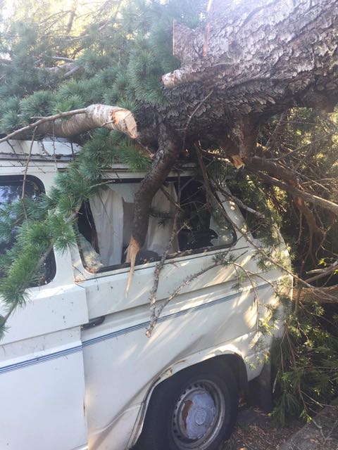

My 1992 T3 Syncro Safari camper was hit by a falling tree in the recent Sydney storms.
Before the tree fell, the running gear was in good shape, the front-end had been rebuilt and a reconditioned VC fitted. The body was in need of some work and that was to be the next project.
The tree was in an elevated front yard and fell across the Syncro onto the street. A branch broke a side window, the pop-top was cracked, and the rear of the body folded, likely after the suspension bottomed out. One tyre bead seal gave way. All doors, including the side sliding door and the rear hatch, still open and close normally. There was no insurance.
I spoke to a body shop about cutting out the rear end and replacing it from another body shell, but they don’t think this is possible as the monocoque is compromised to an unknown extent.
I think there are only two remaining options:
  1. Give up and sell all the parts I can salvage, not my preferred option. I have no idea what all the Syncro specific parts are worth, but I hate the idea of a T3 Syncro biting the dust.
  2. Obtain a 2WD T3 in good shape and for a reasonable price, preferably another camper, and convert it to 4WD using all the Syncro specific parts. GoWesty have done this a number of times ands there are a number of links and videos that show this is possible.
Advice, comments, and any other ideas very welcome.

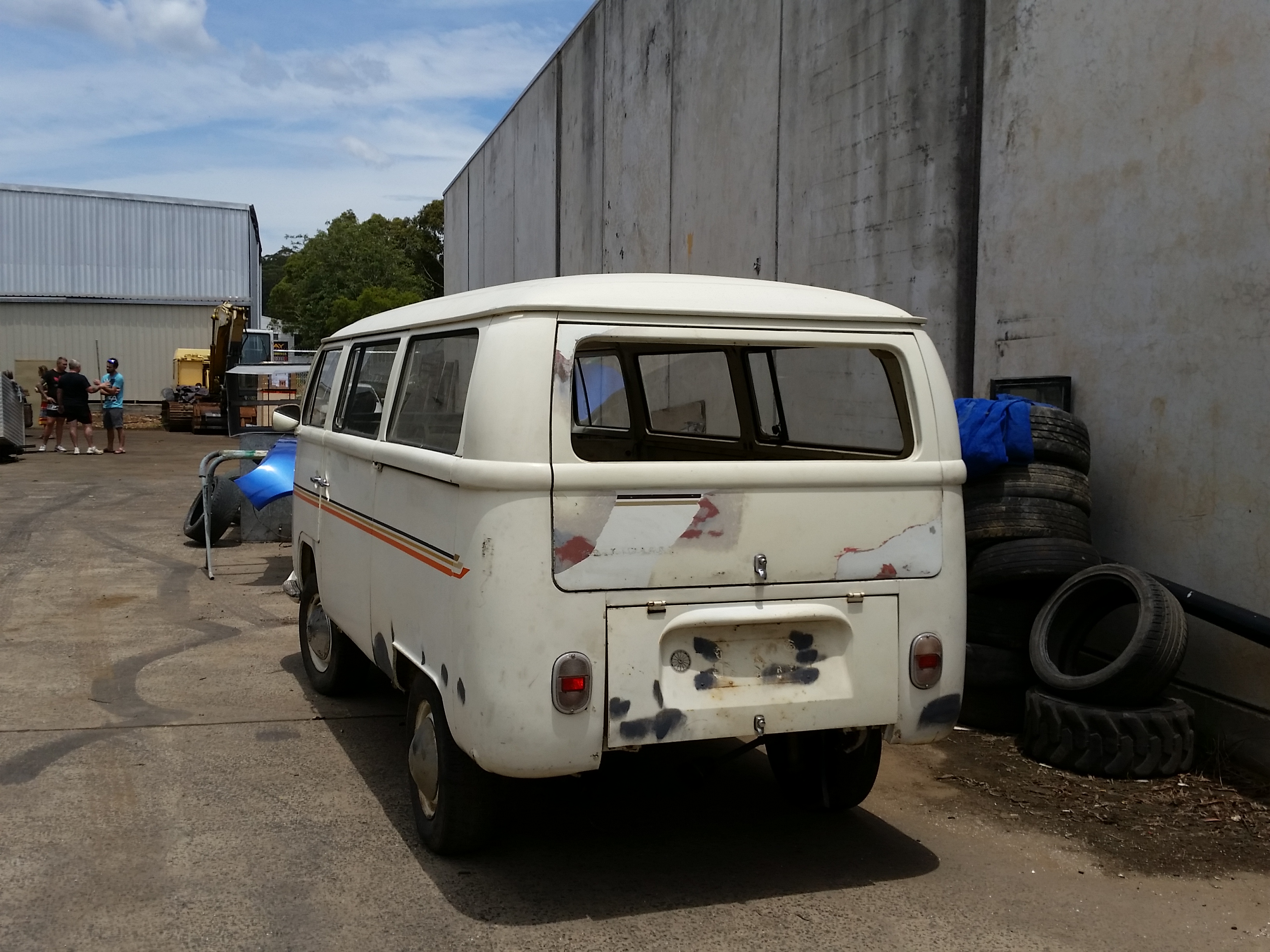

There was a guy on the Central Coast at Tuggerah that regularly cuts and shuts sections of 4wd Utes to repair them after severe damage with roll-overs with 4WDs as insurance just would write them off.
He would just unpick welds align everything and replace sections. He fixed a mates 69 kombi which had a huge frontal collision with buckled roof and floor.

He is in the photo to the left of my old 69 kombi in a black shirt.
I know that doesnt really help but I am working on it.
