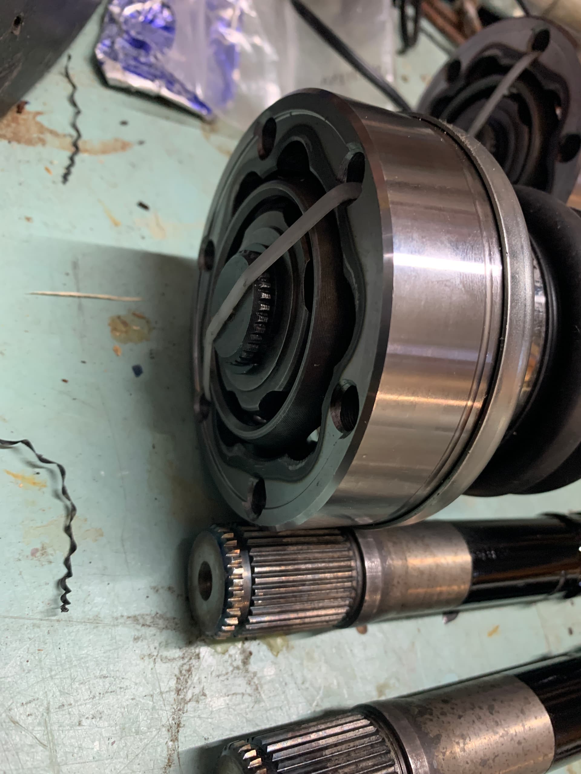

I am new to Syncros, but have been doing lots of research.
I have recently bought two front driveshafts with CVs from Just Kampers, but it looks to me like the standard CV (diff side) has been installed back to front. The line is on the inside and the chamfered edge on the ball carrier is on the outside. I understood it should be the other way around with the chamfered edge on the ball carrier facing towards the shaft.
Refer photo below.
Any advice much appreciated.
Hi Grant.
Have a look at the detailed GoWesty 930 axle installation instructions.
It gives precise information re CV’s.
These are for REAR, but I guess the principles are the same.
Thanks Gerald.
Much appreciated.
