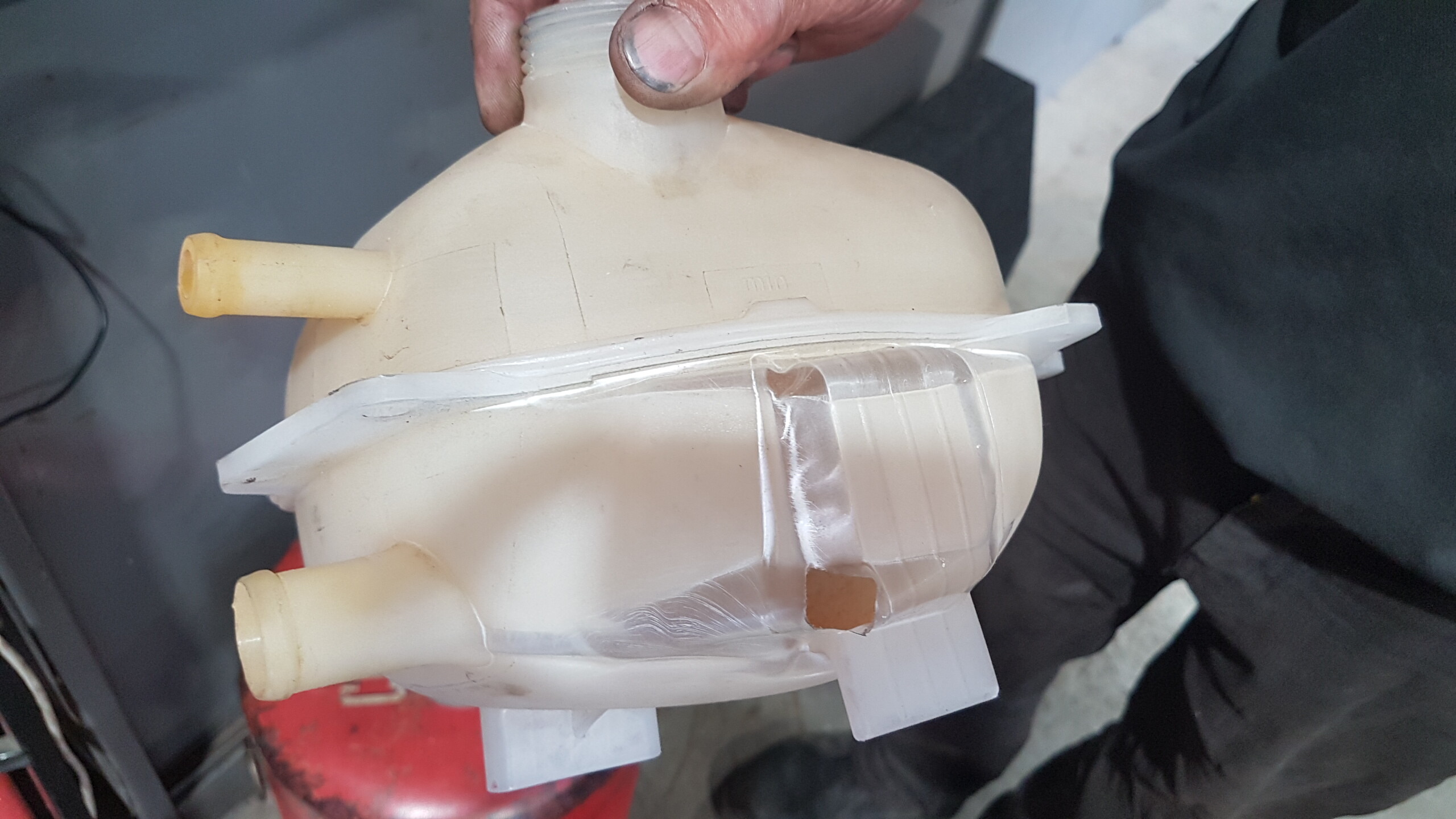

A mate of mine showed me what happened to a novice T3 Owner who drove her newly acquired T3 after the main drive belt and the power steering belt both broke.
The flashing coolant light soon came on after the temp rose quickly whilst freeway driving with said broken belts.
She kept driving until steam started coming out of the back of the van and it lost power.

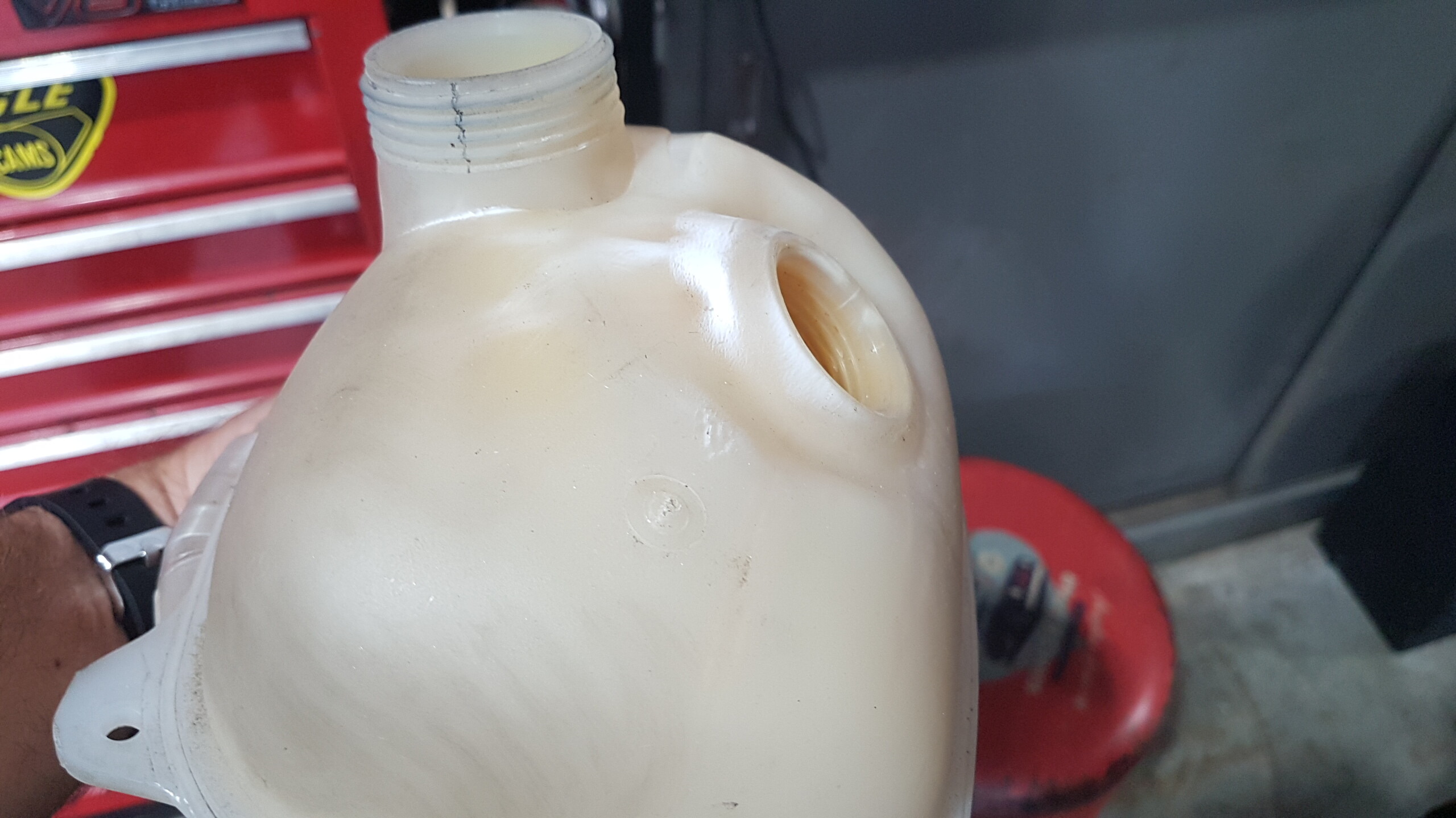

This is what the plastic expansion bottle looked like after basically being melted by the heat created:
The bottom has pulled apart like stretchy chewing gum and the sensor hole has been pushed out like a pregnant ladies belly button - totally destroyed the motor - the oil was like water from the extreme heat.
I’m confused,
So a red light flashing on the dash means stop?
I thought it was disco time. What were those crazy Germans thinking :sweat_smile:
Yes, it seems the flashing lights and needle pointing to the death mark mean nothing to certain people.
They are 30 year old vans and cant be driven and ignored like you just bought a brand new Japanese car.
It seems better instruction needs to be provided to buyers to help stop them killing these poor old things prematurely.
Weird thing was my 2wd did basically the same thing with the A/C belt blowing up and taking out the main drive belt and power steering belt, along with the oil dip stick, the small upper coolant line and gouging a slight hole in the oil filler along with pushing it almost to toughing the exhaust shield.
I still have to fix the oil filler metal arm section as it makes getting access to the oil cap extremely difficult.
I had a warning light instantly come up which was the alt light (which she would have also seen as her alt belt broke) plus the abnormally loud bang that occurred when the belts broke.
I’m just amazed she kept on driving with all the warning lights on and temp gauge pointing straight up until it lost power and steam was pouring out?
Crazy
