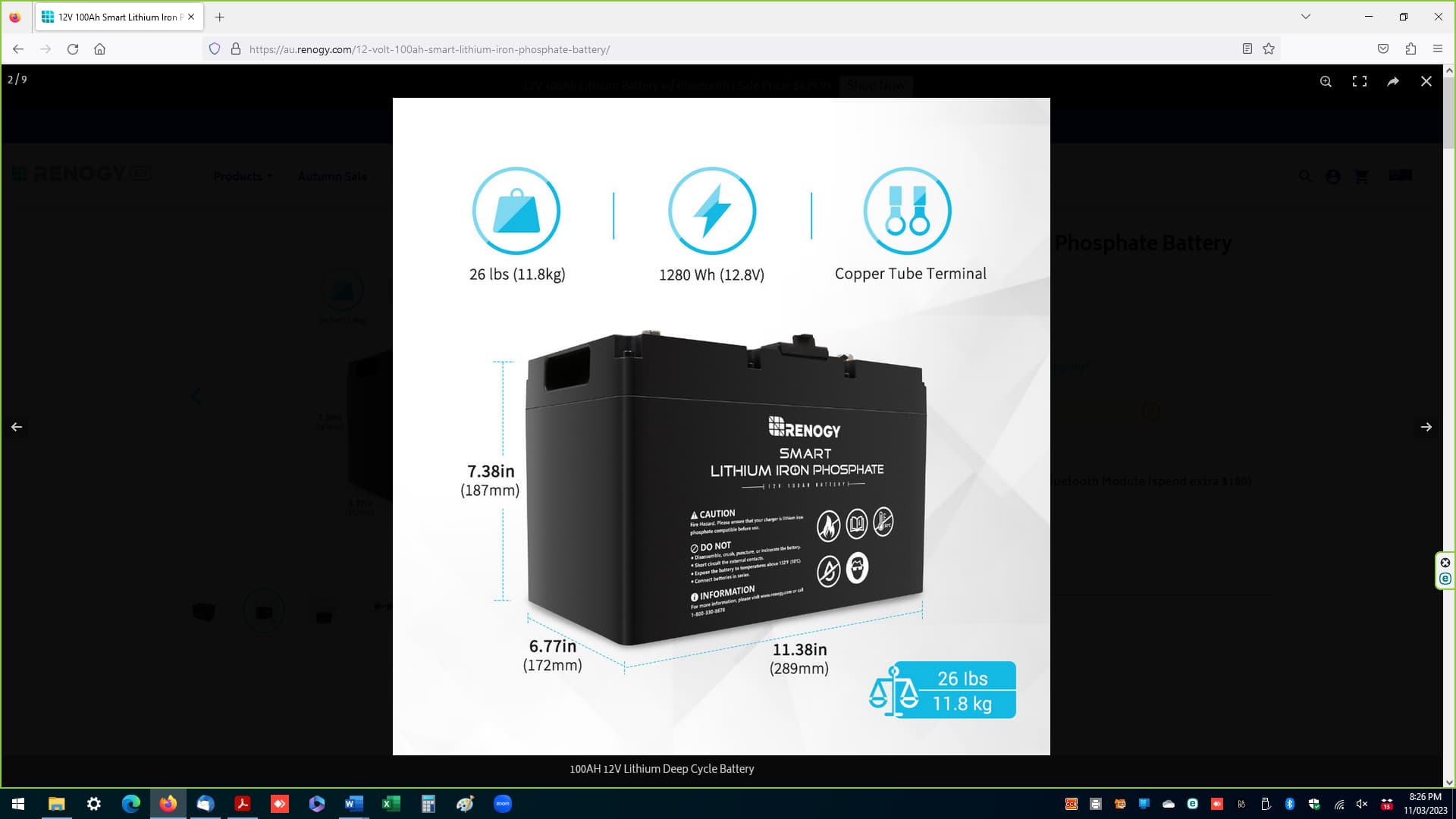

What are the dimensions of the 100ah lithium house battery? Have you modified under the passenger seat? Mine doesn’t look big enough for a battery but it is the ideal spot.
Just fits without the cover on at all and will get under the swivel seat nicely with the terminals missing the swivel base by 20mm (across). So it only just fits.
See diagram below:
