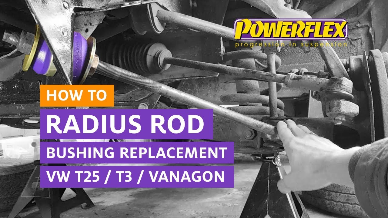

Rudi is no fan of powerflex urethane bushings. Just because they’re easier to fit, doesn’t mean as durable or better performance. Rubber all the way as it was designed.
Hate to raise it, but have you checked extent of corrosion between rubber bushings … forward end of radius rods? Rudi’s son rewelded mine.
A local T3s corrosion was so bad … needed to cut out all corrosion and weld in steel plates. Expect this is happening to all 30+ year old T3s. Apparently leaving this problem unrectified, makes retaining accurate wheel alignment problematic.
Thanks Ken, I have not been in a van with powerflex, but am happy with the performance of the originals, so no plans to go away from standard.
I have had most bits apart in the front end, and always clean/paint/grease as needed, so not real corrosion in mine so far!!

Just to be clear with what Rudi found with mine, the full extent of corrosion cannot be seen until both front end radius rod rubber bushes and their metal “washers” are removed. Then and only then, can it get fully ugly.
Video shows not all corrosion is removed nor adequately dealt with, so rebuild is compromised.
Same Gerald, Bus Depot. It’s scary when you look at various sites how much is out of stock! I hope it does not mean the market will be cheap rubbish to satisfy demand
Thank you for the video Ken, I have had mine out once just to have a look, but will be sure to look at it again. I’ll have a look over the week end what else may need doing. I see one of my ball joint boots is aging, if I can source the boots I might replace them also.
