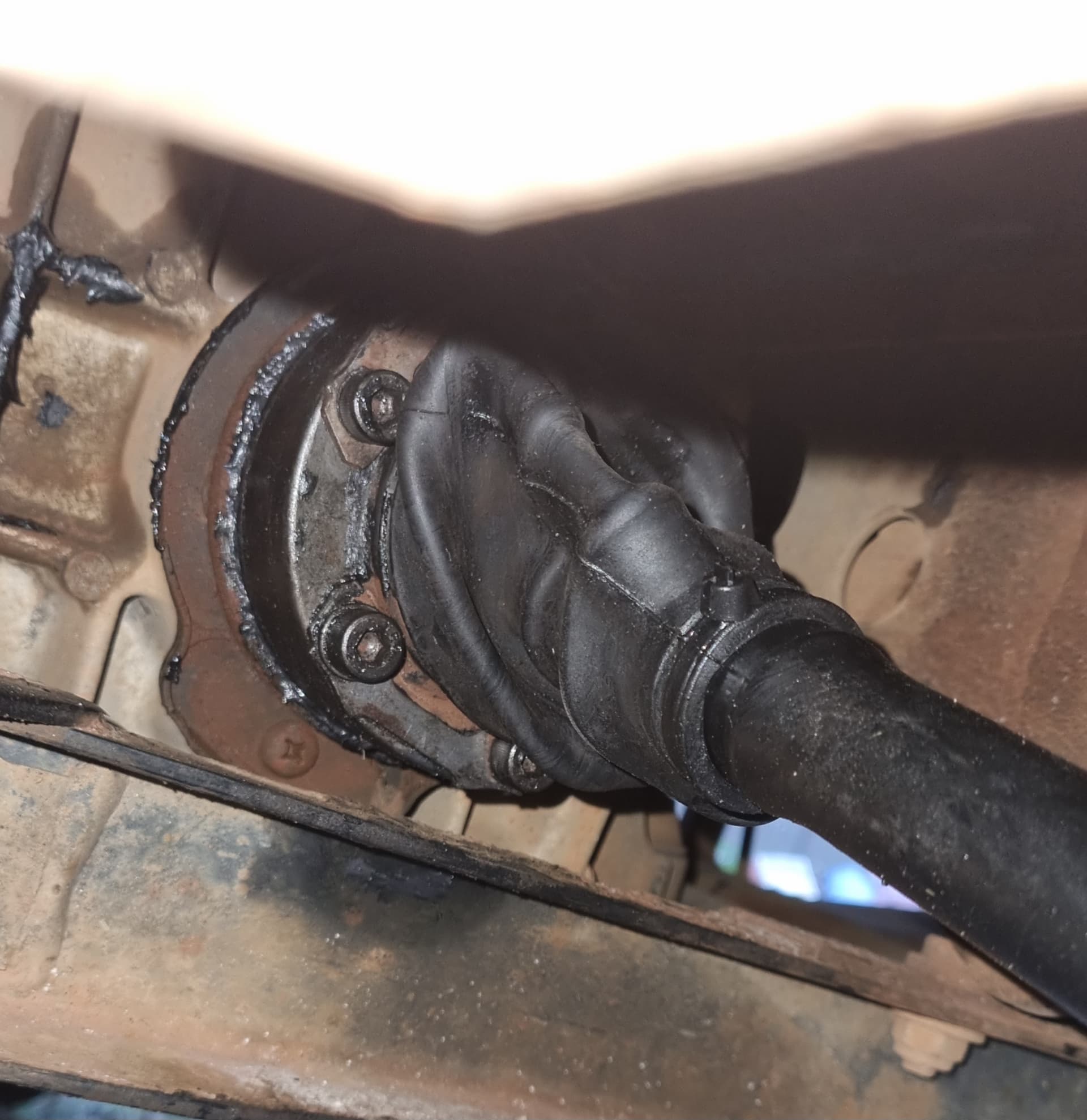

Done!
A bit of fun and games but easy with a good mate to help.
Fitted new OME front shocks while in there. Might be a bit high now.

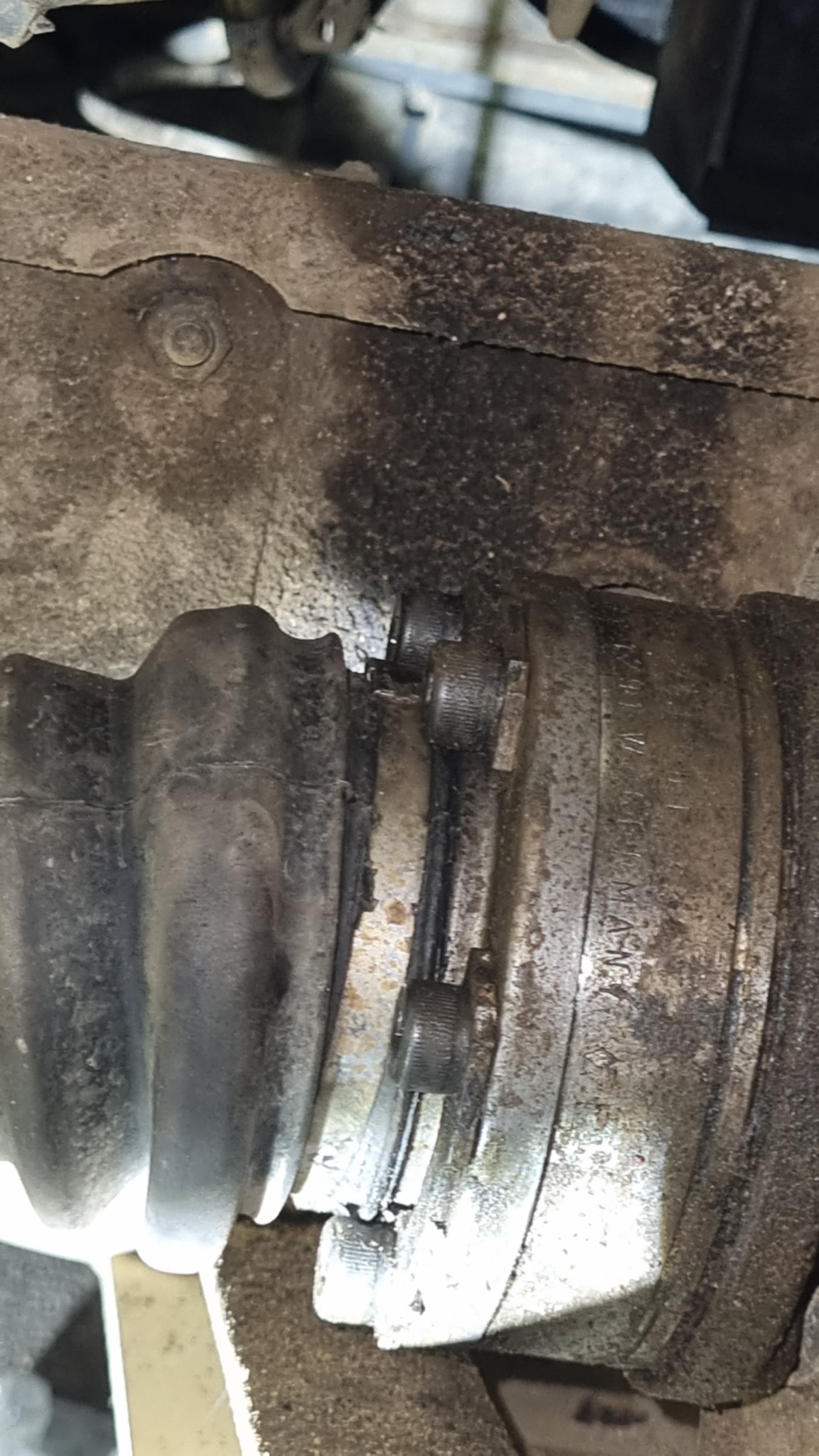

I’ve just recently put my rhs front inner cv together. The circlip came off when doing other work. Just changing wheels around this arvo and had a look to see if it was still OK.
It looks like the life has been sucked out of it
It’s not sitting even like the others.
Would anyone know the cause and is there a fix or leave it alone?

It seems the only way that could happen is if there is twisting the CV joint/ end of shaft and the rubber boot grips too hard on the shaft. It would be more understandable to the outer CV joint, yet not the inner.
Maybe your zip tie to the shaft end is a bit tight?
Thanks Scott. I’ll remove the cable tie and see if I can slide the end in and out a bit. That may fix the look a bit.
That does look odd Neil,
The end of the boot (on the axle) looks like it is in the ridges where it should sit? It would have to be a long way out (boot pulled towards wheel) to stretch it that far?
It almost looks like the whole axle has moved towards the wheel. Does it drive fine including when turning?
The front inncer CV should have a spacer behind it. Could the spacer be missing?
