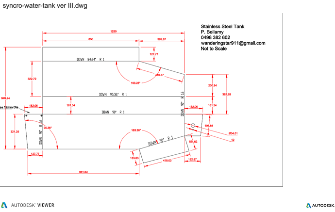

I’ve just finished CAD drawings for the tanks and sourced a local machining shop. They quoted me 300AUD to fabricate out of 304 SS. I’ll use the 2wd filler cap and a spare fuel pump (which is handy to have with you on big trips anyway). If someone wants to go that route I’m happy to share files.

300AUD is for the welded tank with spigots/nipples for filler, vent and outlet, 2 baffles inside, fluid-tight. Mounting straps, hoses, pump, filler cap etc. not included - have to sort it out myself.
I'm doing this for myself, as am prepping the van for our big trip in September-October (Brisbane - Alice Springs - Simpson Desert - Brisbane) and need to carry a lot of extra fuel.
I don't have time to organize this for a group buy/fabrication, but as mentioned am willing to offer CAD designs and pdf plans/drawings for anyone to use "as-is".
I will release plans and pictures after completion and install of my tank, so anyone can decide if they want to use it or not.

Folding will eliminate many of the required welds
Sounding great Beau. If you are going with the EFI pump like I have, you might need to think of a way to prevent starving the pump when the tank gets low (maybe a little baffle around the outlet pipe?). I have been running mine for a few years now, and generally run the second pump until I feel some hesitation when driving. I know these pumps do not like to run dry, and I have noticed the second pump sounds a little nosier now than when it was new.

If I was to design my own though, I needed to add notches to the top of the tank to clear the mounting bolts for the (factory) middle row seat. This allowed me to pull the tank hard to the floor.
I also used 4 straps (not just two it came with), and I would have put 4 baffles in the tank to line up with the straps for added strength.
I also would have (internally) run the breather to the middle of the tank to stop surging down the breather when the tank is full.
I can’t remember the thickness of material in my tank, but it was quite heavy, and could have easily been made lighter. You could put a second skin on the bottom if you were worried about damage off road.
The other mod I would have made is a collection point internally at the outlet. The idea would be that it fills easily but traps some fuel there. So if your tank is getting low and you are breaking or cornering, the pump does not run out of fuel immediately. The factory tank does not have much fuel in the tank if you run it dry. This tank typically has 5L or more unused when empty unless you try and run the pump on hills etc to try and drain it fully.
This is an issue for me because I run two EFI pumps. The EFI pump (stock Bosch one) on the auxiliary tank runs the engine as well as transfers petrol, so I need to be aware of where I’m driving when I use the pump otherwise the engine runs out of fuel (and it’s not good for the EFI pump). this is not so much an issue with a transfer pump.
I set mine up this way for redundancy. If I ever have running issues and suspect the pump, I simply swap pumps and see if that helps. I also don’t need to carry a spare pump, as one is mounted permanently to the van.

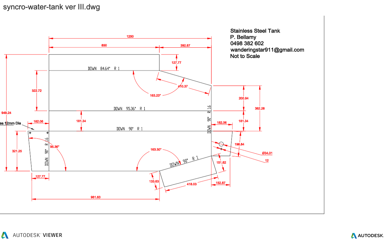

No worries. I got hold of Peter’s file. Attached is an image of this for reference.
Thanks for the advice @cathrich1. I will try and add this into the design. All valid points.
