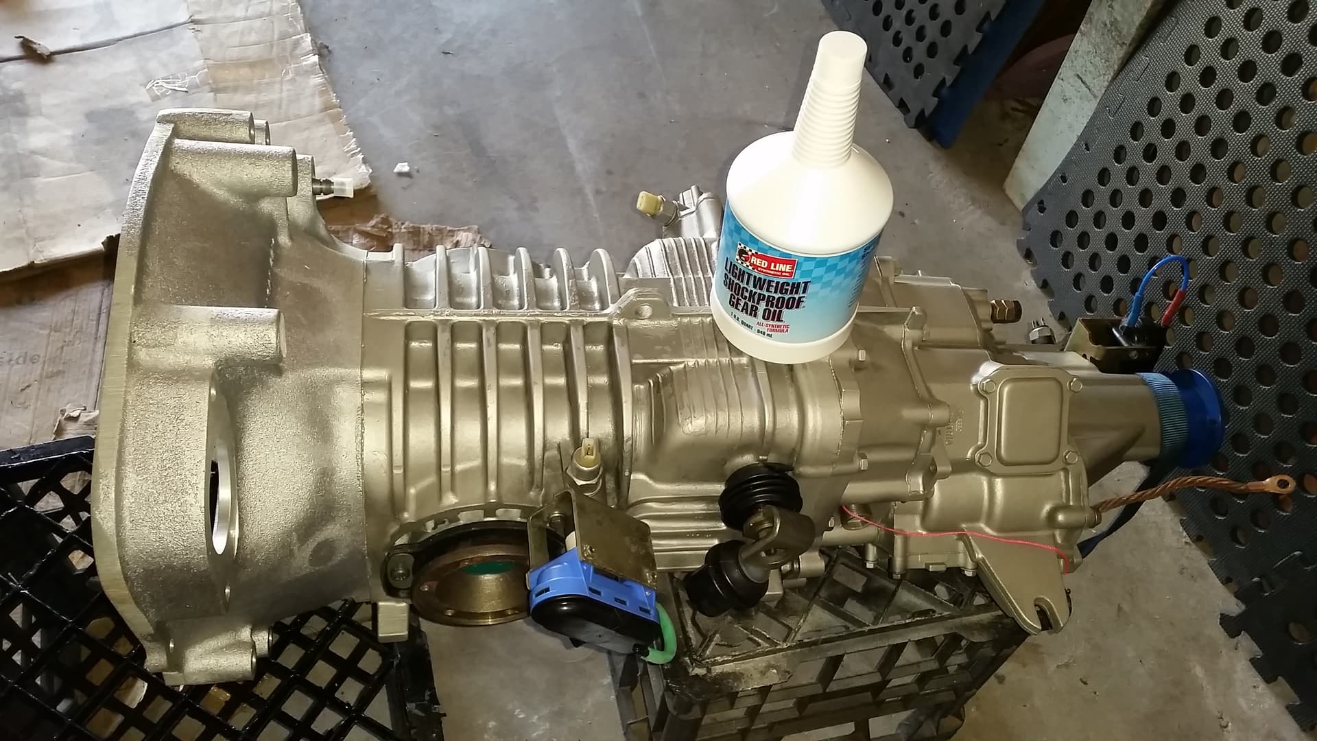

On Rudi’s advice I went with the Redline Light weight shockproof gear oil.
I changed it after 25000kms and it looked fantastic - went a purple colour and a bit sticky but there was only a tiny amount of shavings on the sump plug and in the oil drained.
Went for the same - gearbox still working well and quiet/ smooth.
Love it!
Thanks Scott. Great to know.
Interesting choice as the redline web page recommends MT-90 75W90 GL-4 and 75W90 GL-5 for the front diff
I have 75W90 GL-5 in the front diff still.
This oil came recommended from a tried and tested professional syncro gearbox tech so I am happy to take his advice.
:+1: Thanks Scott, I’ll look into some local suppliers and see whats out there
