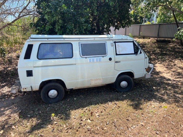

Hi all Gaz here from Humpty Doo NT
Hi Just purchased my 1st T3

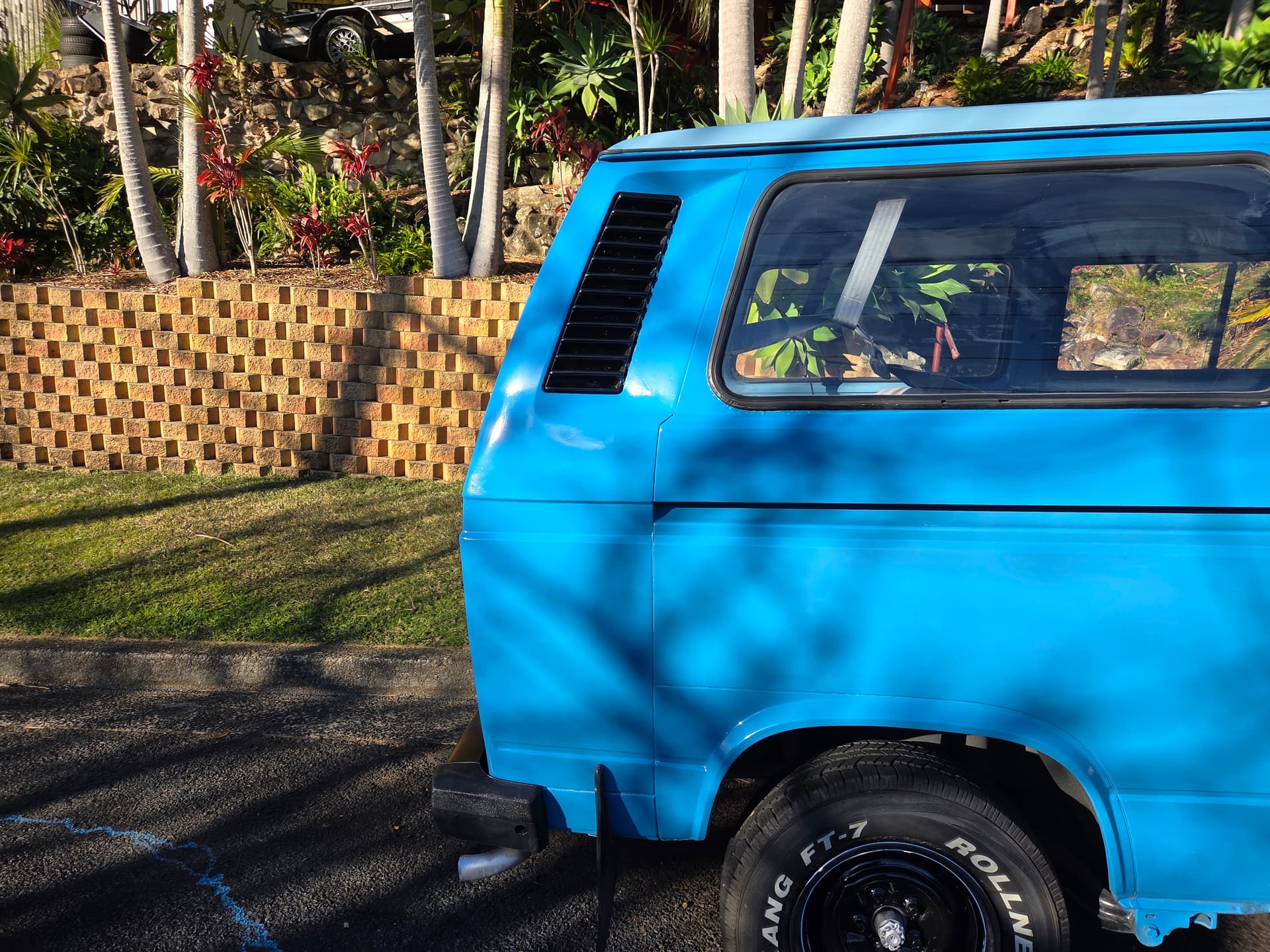

It started life as a Basic Syncro Transporter van March 1992
Was converted to a camper pop top a good few years ago by the 2nd owner as well as seating for 4 (RocknRoll bed)
Needs a bit of Love (rust repairs and Mechanicals) and then additional seating for 5
will update as i progress

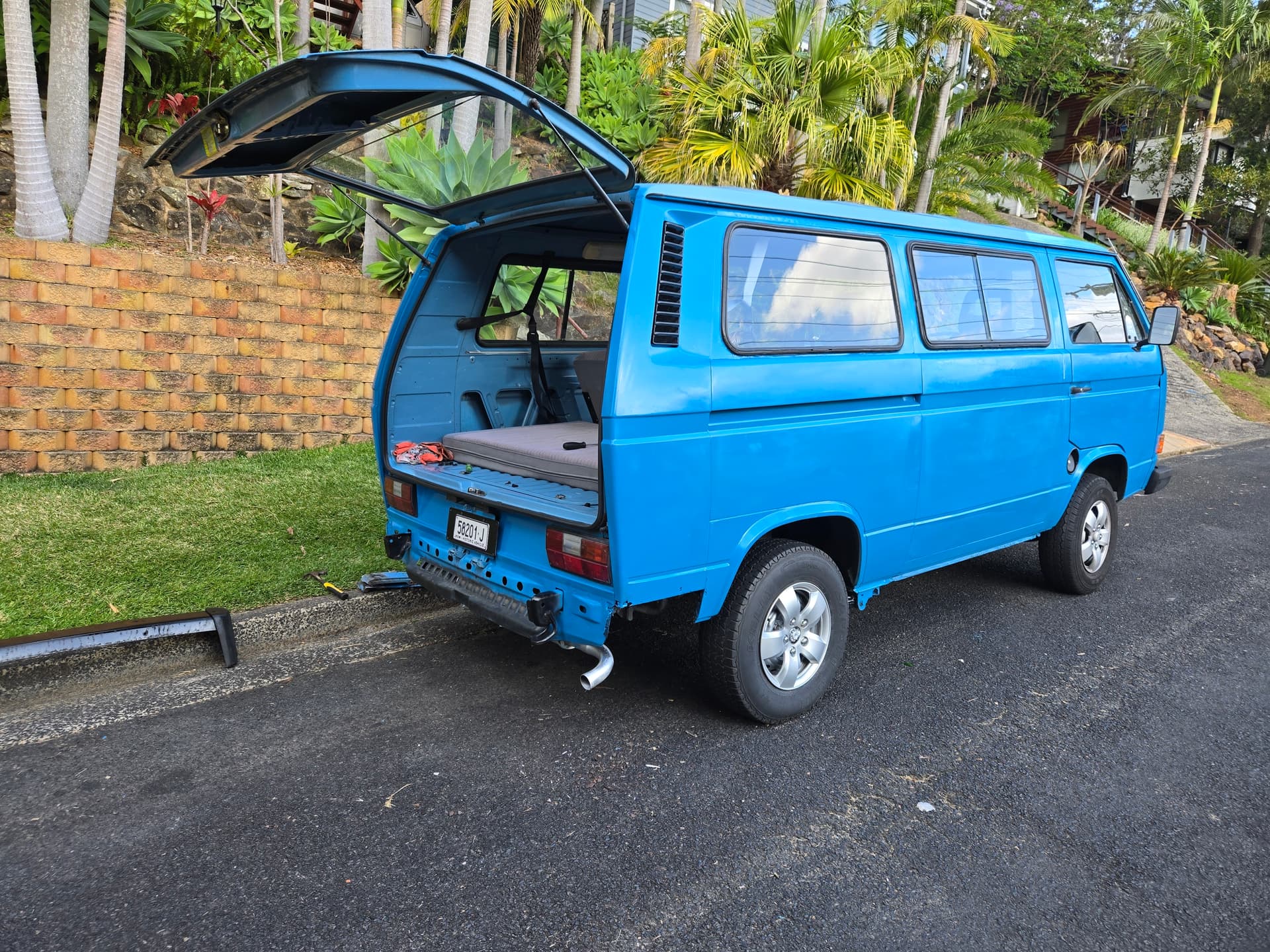

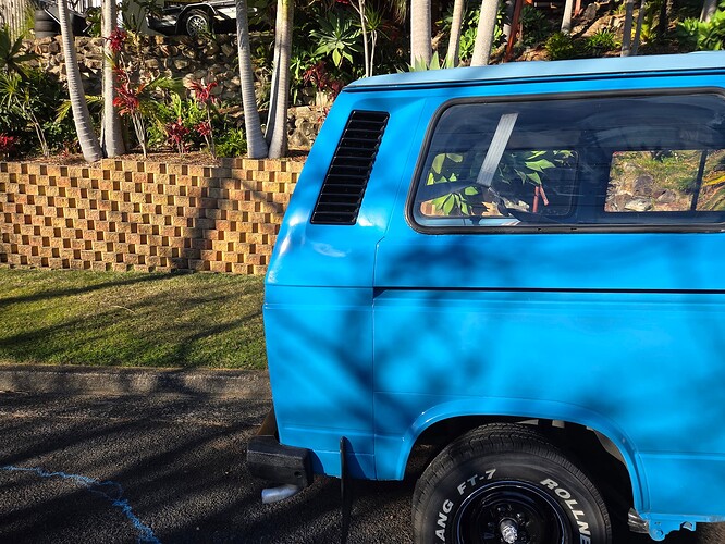

Nice Camperize syncro you have there Gaz.
Unusual setup there with the middle drivers side awning style window - Was it originally a panel van?
I have done the same rear side corner rust repair in a couple of my 2wd vans. Looks so much better with the new panel in there.
Yours looks fairly rust free other than that.
Yep believe it was a Panel Van for its 1at few years

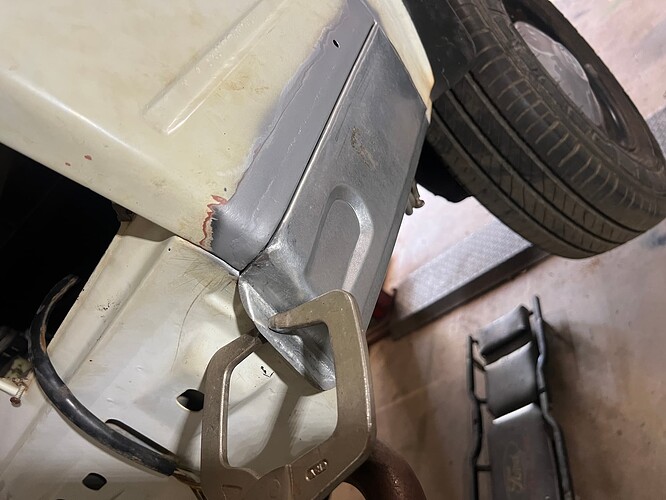

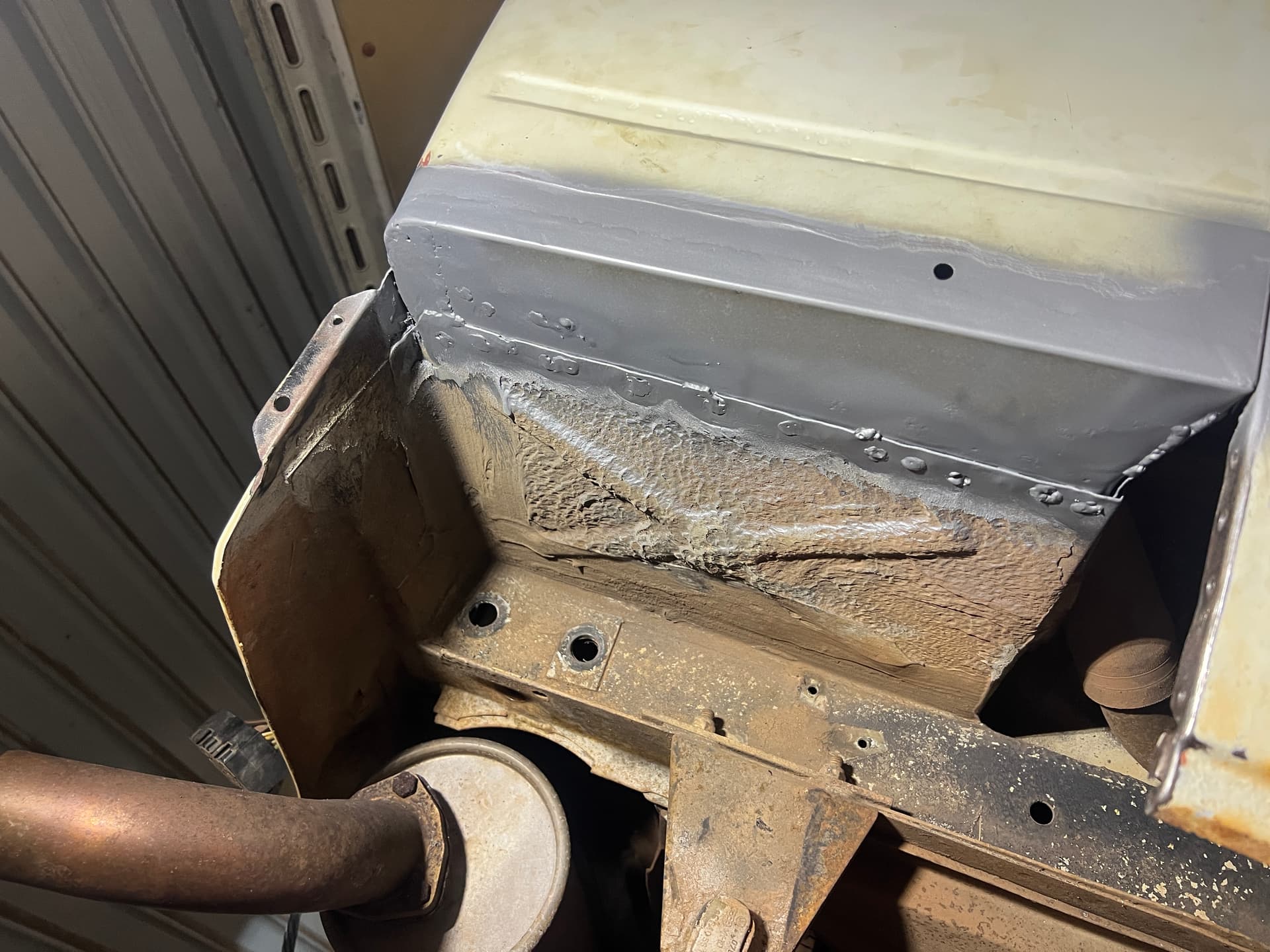

Little bit of progress fabricated some of the lower panel today
What was removed well was a lot more than pictured gotta love spot welds :lying_face:
The repair in my photo was the second go as I had a tyre explode on me which ripped the replaced lower rear corner almost off and dented all around it including the battery tray.
Took quite a bit of massaging to get it reasonably straight.
The joys of classy and classic car ownership

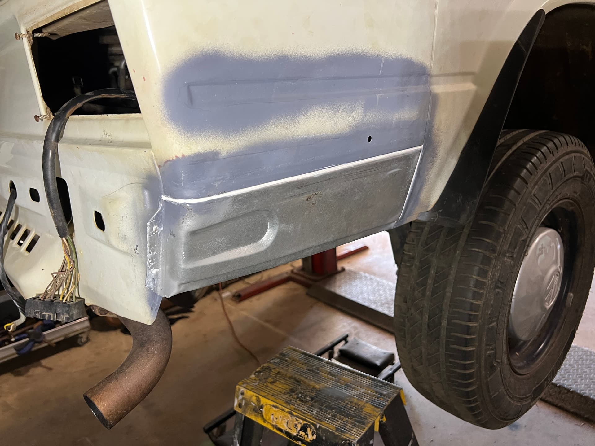

Bit more progress
Replacement panel left a lot to be desired and a fair bit of Ferrokinesis
Nice work.
As noted by yours, often the case is that the rot gets the edge of the “battery tray” in next to the tail light.
I found that out when the tyre exploded as it tore pieces of rust off.
You can do an ugly job to that as you cant see it so welds don’t need to be perfect…
Its worth drilling a hole to the centre of the battery tray X around 10mm in diameter to drain and help stop it rusting again.

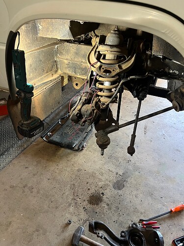

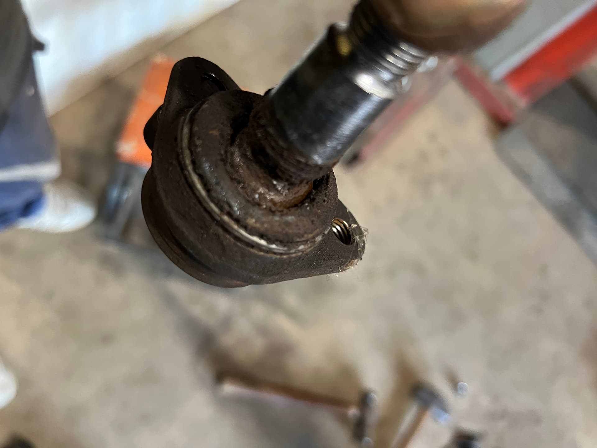

Started work on the front suspension and CVs
Small bubble in the paint
Dont think this upper ball joint has ever been replaced

Little update been replacing all bushing’s and bearings etc on the front
OMG what a pain it was to replace the lower swing arm bush

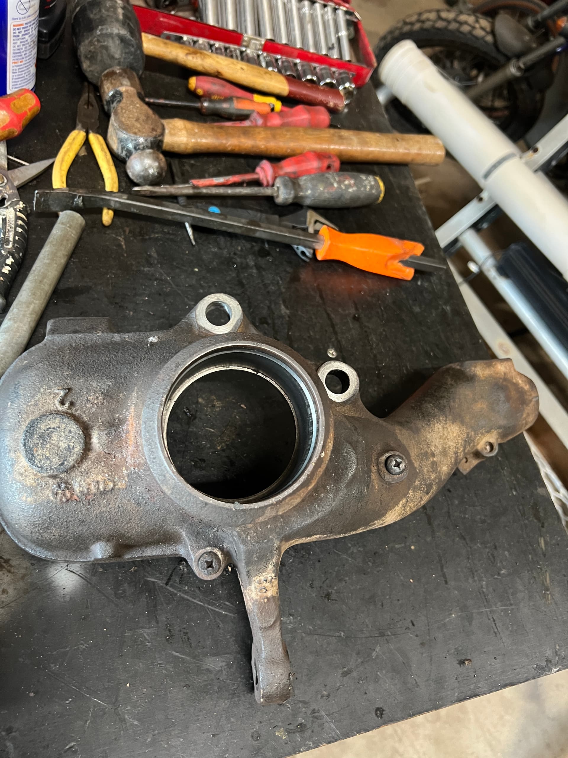

Wheel bearings replaced another root of a job

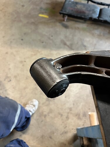

Do you have a press to get the bushes in or use a home made system with washers, bolts and nut?
I just have a small 6 tonne press bought from super cheap way back in 2011
Tried a few things to get it in mostly overthinking all up 3hrs of no progress
Then just do or die moment kept applying pressure and lube till the lip popped in and pushed through
So Near Side bush pushed in today
As mentioned its a little tricky i think i got this in on the 28th attempt.
