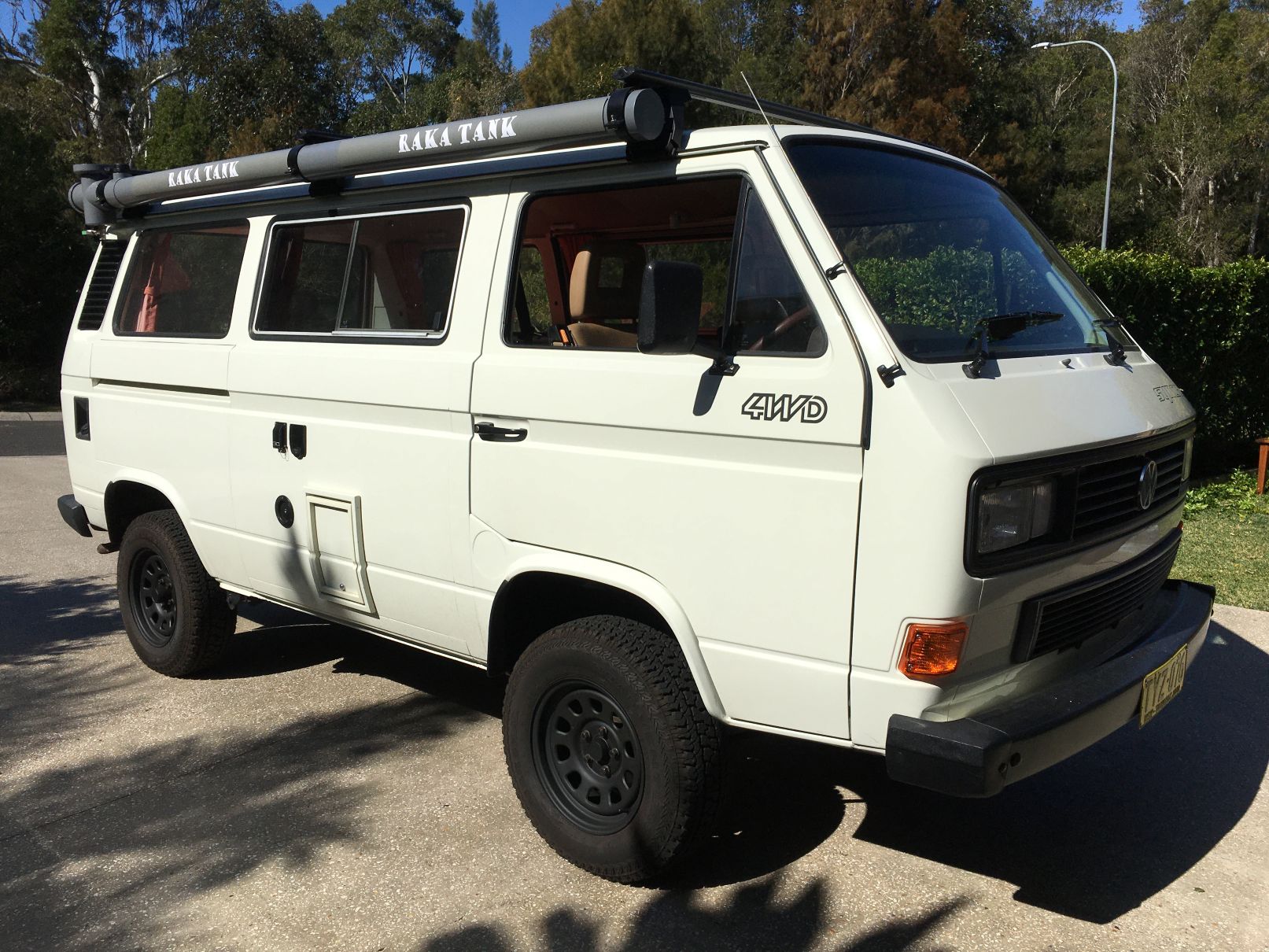

I need a new set of tyres for my ‘89 Trakka Syncro. Ideally after some moderate all terrains - good for the highway but can handle some light off road, namely beach tracks.

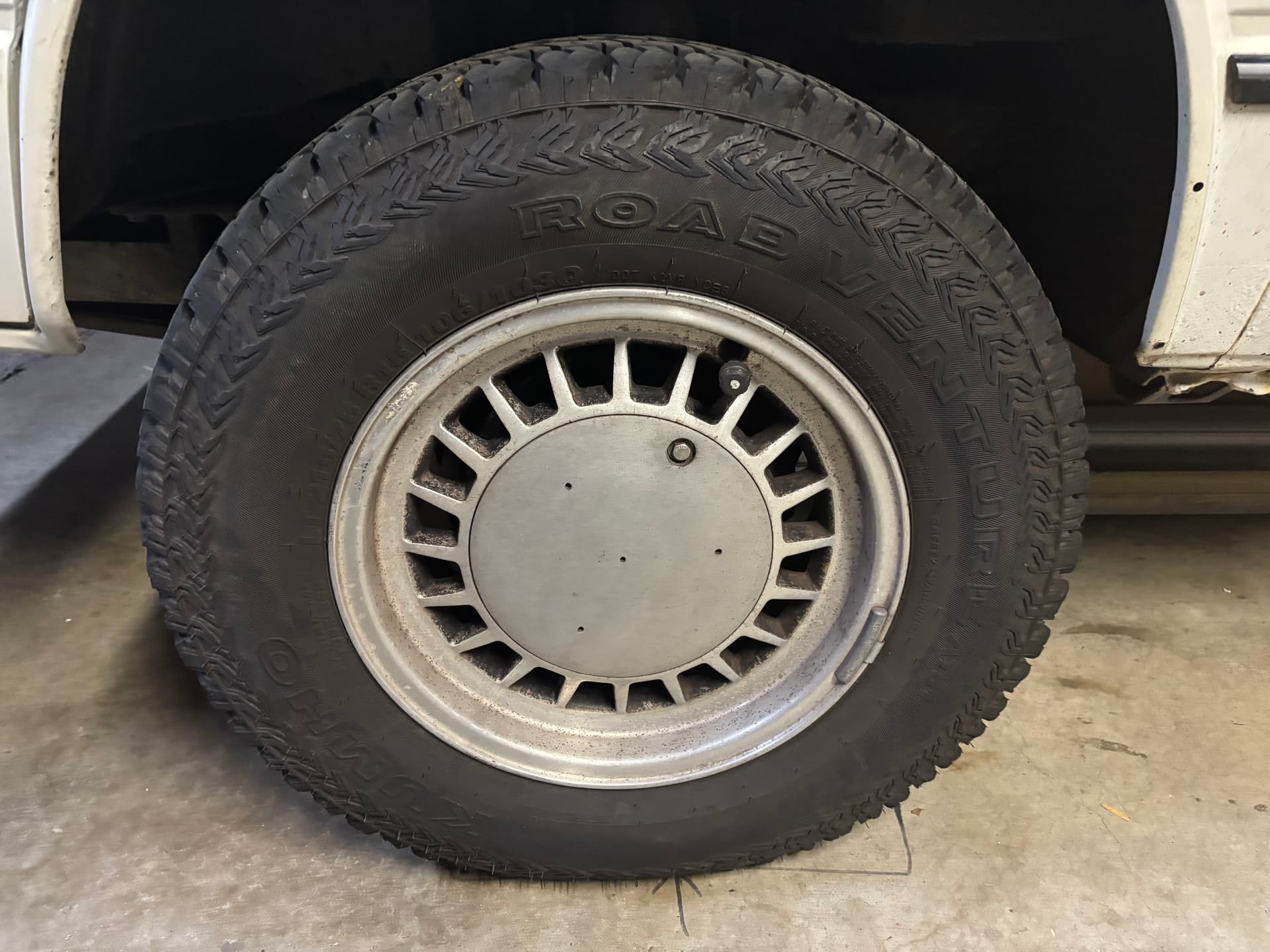

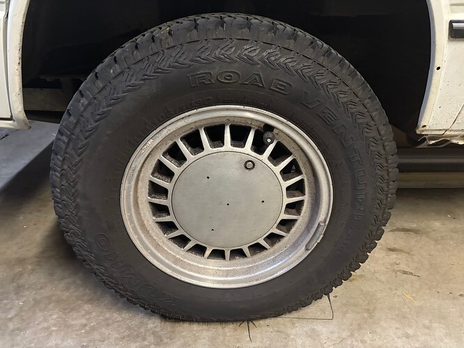

I also have a 1990 Trakka Syncro

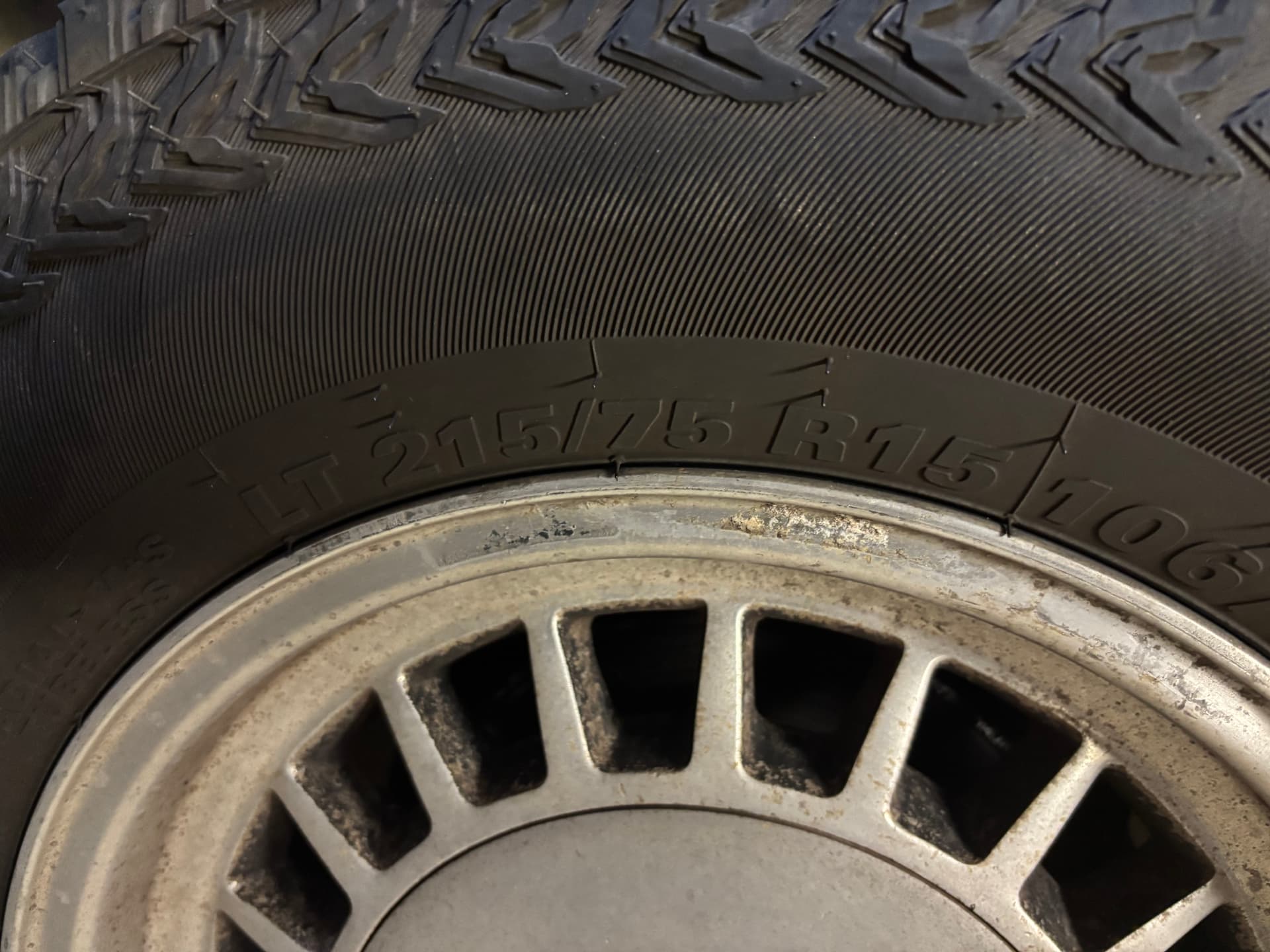

I have been running the Khumo Road Venture AT51 215/75R15 106R
They are a bit larger than the original tyres but I have a Subaru conversion so a slight gearing change was fine.
They have been working fine, not too noisy, and plenty of grip off road.

I too have been running Kuhmo AT51 215/75R15 106R’s for the last few years & have found them to be very good. My van has the original spec’d engine, no diff locks, I don’t commit to major 4WD adventures, & as per you it’s used mostly for moderate all terrains & sandy beach tracks.
