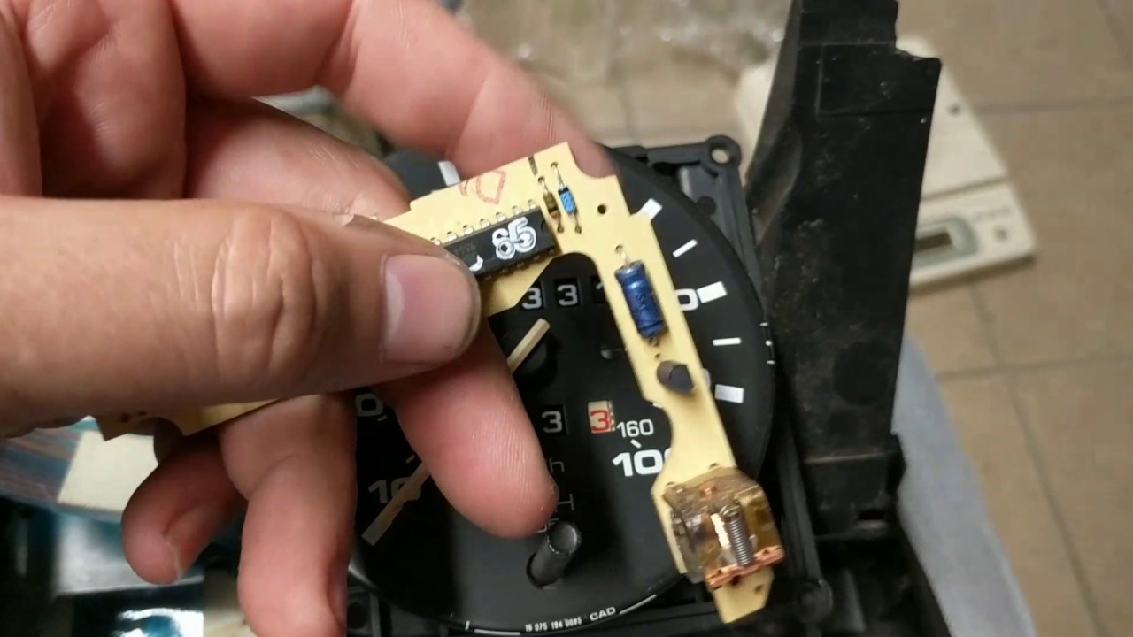

By the way, if you are still having trouble with the buzzer of doom PM me and I will let you know how to solve that issue.
Thanks, I unplugged the module for now.
The aftermarket oil pressure gauge will have to do.
Hi Leon,
The best way to get rid of the buzzer is to bend down the pin closest to the centre of the speedo where the ribbon attaches.
Only the high pressure sensor is connected to the buzzer of doom so if you take just the buzzer out, your oil light will still flash on start up and go out unless the oil pressure drops really low and it will stay on.
I did this with my spare 2wd and it works great.
Everything else works but no buzzer or light on - except start up as it should.
Keep your oil pressure guage though.
They are better than the factory system.
Watch the above clip which explains it better
