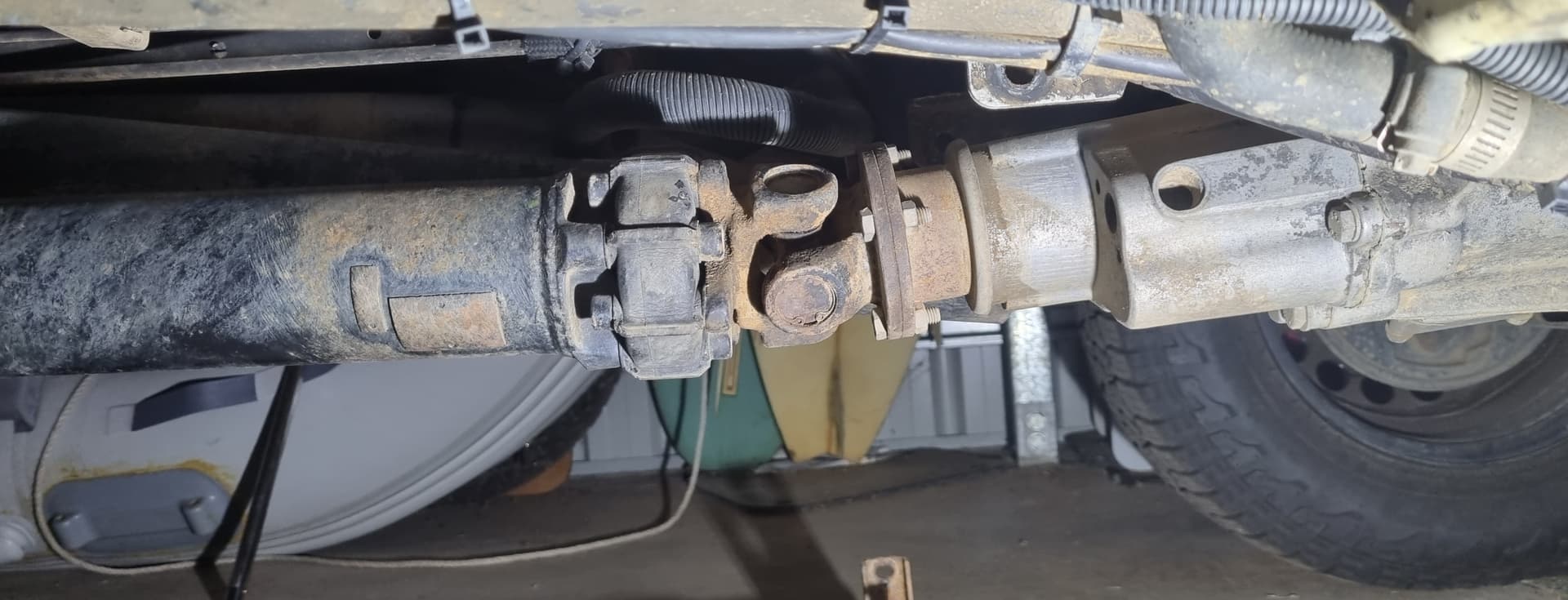

Might pull the tail shaft and see what it is like.
Tailshaft out.
Rear uni is stuck in one direction. I suppose that would do it.
Quick drive and no vibration.
Now. Where to find a uni joint. And should i get the shaft balanced with the new joint?
If the uni joint is stuck, and no play, it could just be lacking lubrication. Not sure if it helps, but I annually remove the shaft and clean it externally, drop each end in a bucket of grease and warm it up, once warmed I work the joint around for a while then let it cool in the grease. The hope is any air is pushed out and a little grease may get in past the seals. Without grease nipples they only other way to grease them would be to remove them.

There seems to be a tiny bit of play in the stuck side.
I’ve been reading around and my angles of the drive line seem excessive as well. Bit of shimming coming.

My central tail-shaft did that and I had a Hardy Spicer unit joint installed in its place which matched yet had grease nipples so it is serviceable.
It worked well.
Thanks Scott.
Have ordered the one from brickwerks which has a grease nipple that has to be removed.
Hopefully goes back together with no vibration
