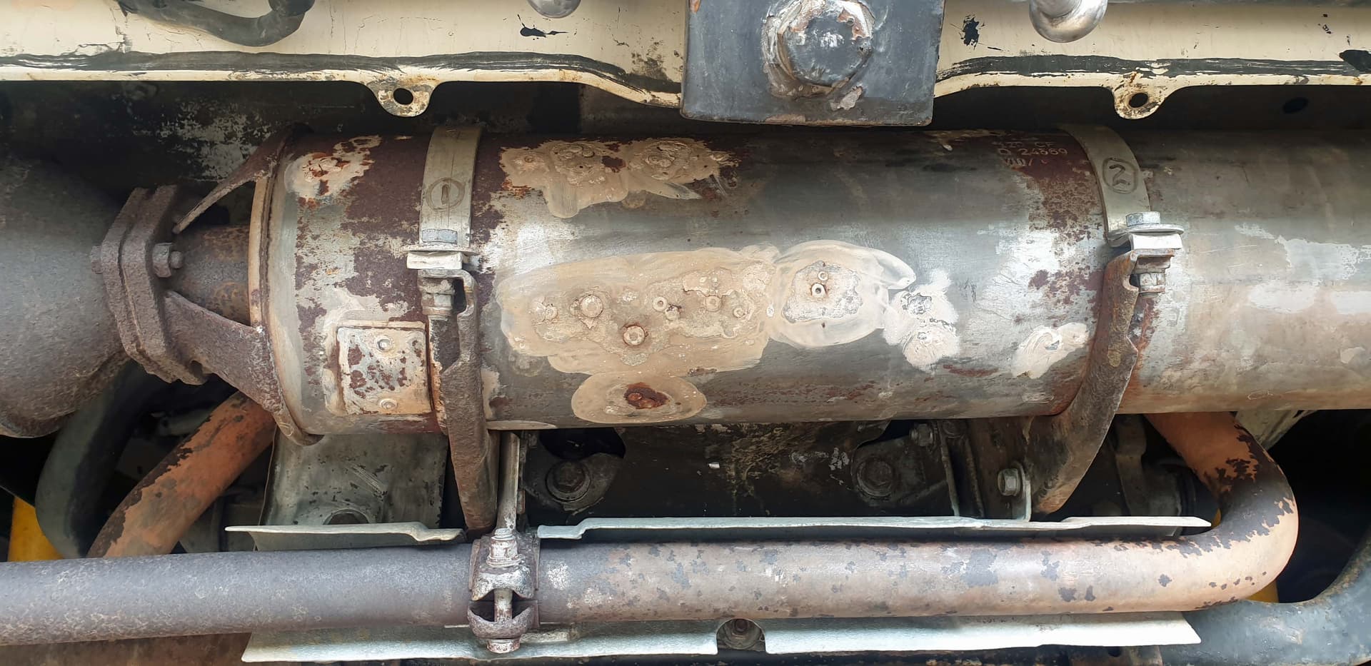

First, check out the final state of the old muffler. I learnt a lot about never ever again attempt to prolong a life by patching a stuffed muffler already in its death throes. On a positive note, going through the motions enabled me for the first time, to learn about its R&R. This helped later for the final assault!

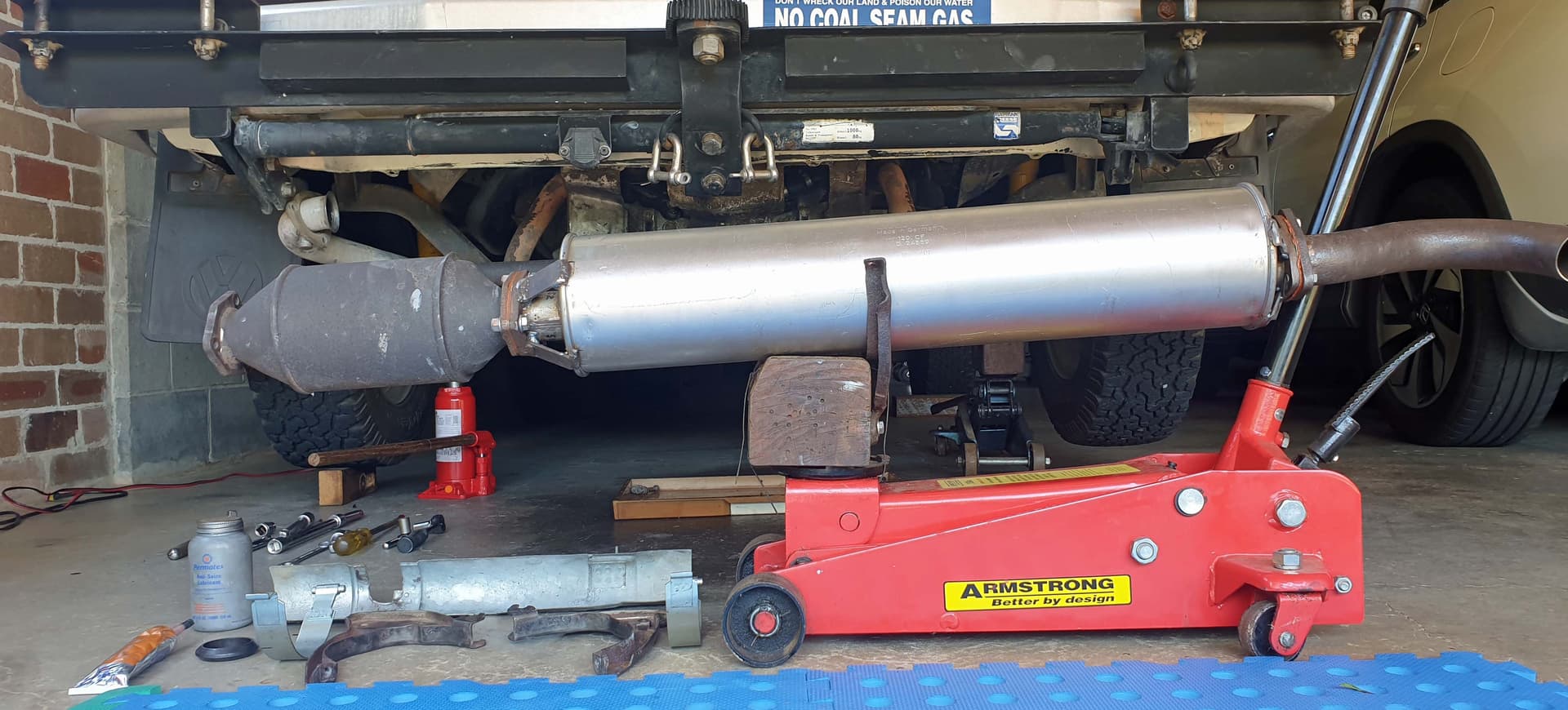

So what was changed was a new Danish “J” pipe, two new donut ring end seals for it, the new ERNST muffler with new topside muffler straps, all new gaskets, new nuts, bolts & washers everywhere with added anti seize applied, and of course the addition of the silicone sealant to all ring seals and gaskets. So I chose to reinstall the existing cat which of course is totally empty, also reinstall the two muffler support brackets, also the correct “syncro” version Danish tail pipe, which I’d previously changed years ago.
I was aware a previous owner had added at both ends of the muffler, six in all steel support braces welded in place between the end flanges and the muffler casing. I’m also aware there’s a hell of a lot of vibration going on to this part of the exhaust system so I figured it would be prudent to err on the side of caution and have similar 6 high tensile steel braces added to the new muffler before install. See some of them in the pics.
First assembly thing for me was to loosely fit in place the “J” pipe without the donut ring seals in … worry about them later when alignments need fine tuning.
Next, it was tough going, but the 6 ton floor jack just managed to lift the weighty muffler assembly into place. HA!
So refitting the shown muffler assembly, I don’t know how others do this, but what worked for me was to loose fit only the leftside muffler bracket using only the bottom bolt so the bracket sags down (helps clearancing), then raising it on the jack, roll the muffler assembly sideways from right to left, then slide up over the sagged bracket till the leading cat flange reaches the “J” pipe flange. Then raise the muffler, fit the rightside muffler bracket, then loosely fit all four bracket bolts, ready for fine tune fit.
While the muffler brackets are still loose, then fit in place the top muffler straps. Leave the straps loose for now, this helps during trial fit and alignments.
In the end, trick I figured was to fit all bolts and nuts of the “J” pipes and muffler brackets & straps, so as to then carry out a trial alignment of the remaining two joints.
Interesting how shifting sideways or raising or twisting the position of one or other component, alters for better or worse the fit of the two remaining loose joints of the “J” pipe at both ends and alignment to the cat flange. Idea being you end up after some trialling with the best achievable joint alignments. I also found during trialling and final fit, very helpful given I don’t have three hands, was to use an ocky strap to tie/hold the “J” pipe about two thirds to the rear so as to retain it in its approx. final position. Without that, makes the alignment much harder, especially more so while applying silicone sealant to both joints and fitting the two donut ring seals in quick succession, before the sealant starts setting.

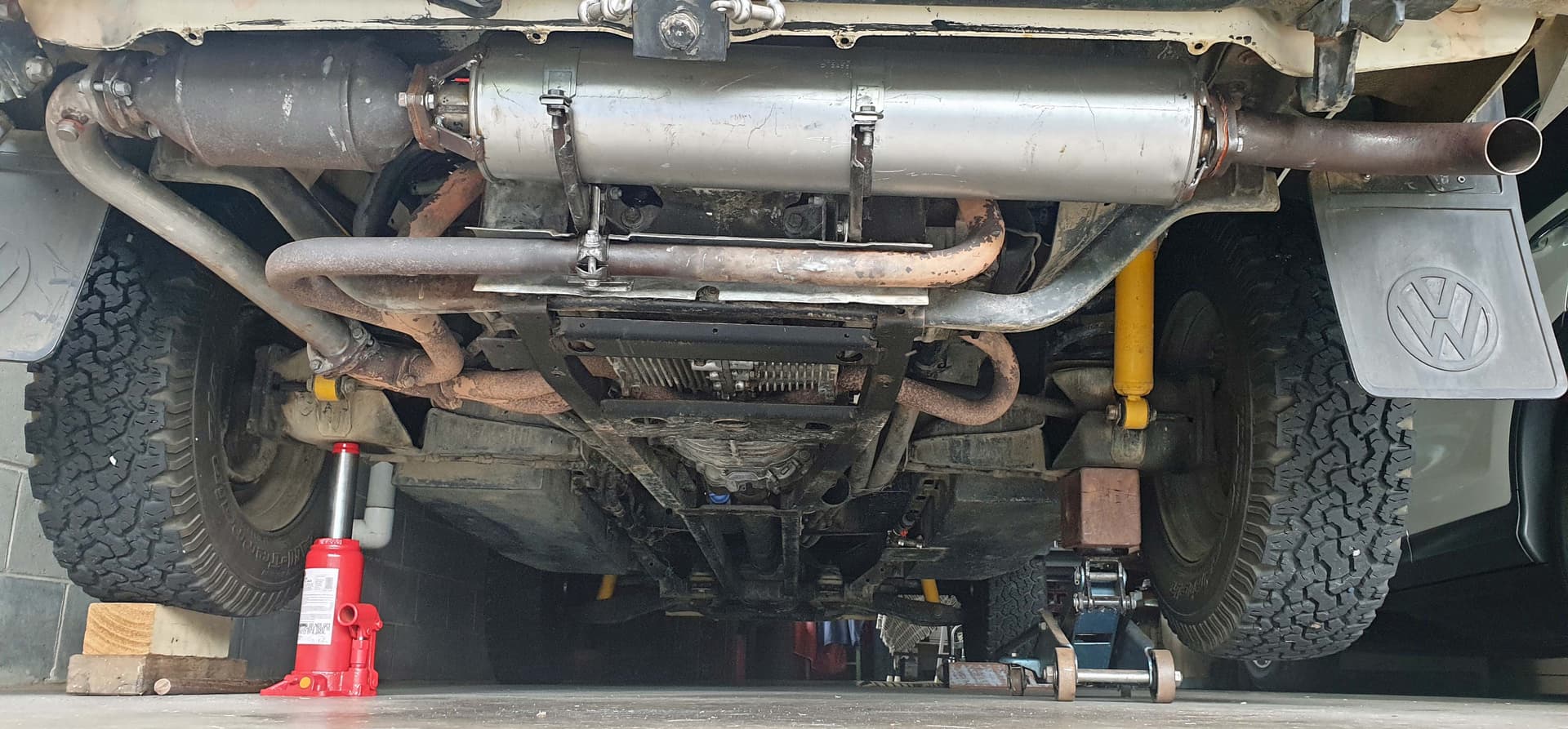

While here, I’m curious to learn whether or not other syncros here do have installed the metal heat shield as is seen on mine in the last pic. It can be seen fastened in place below the muffler, located on the horizontal left to right exhaust pipe. Keen to know if everyone reading this does or does not have it in place. Also if you have it, its present condition. In good nick? Falling apart/cracking up/metal fatigue? That sort of thing. As I understand this part is definitely NLA, I repaired mine.
See ETKA schematic .pdf file below. Heat shield is shown at Position # 39. Part # 025 251 631

No, I do not have that heat shield on mine
