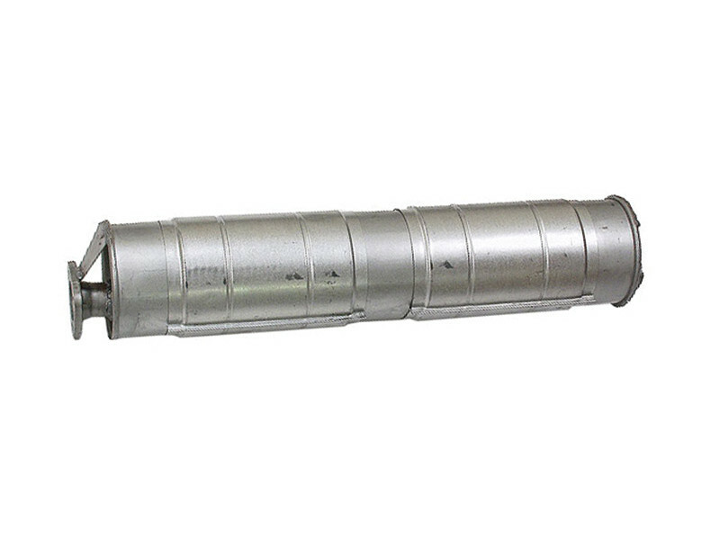

When I was searching for a replacement muffler, noticed most suppliers (except Europe), only had an aftermarket version with a two piece built-in outer heat shield, which I figured would make it harder (or impossible) to slide it sideways to fit, especially when the muffler bottom support brackets are in place.
So I felt lucky getting the Ernst OEM muffler without the added on heat shield which in my view, acts as an extra barrier for the exhaust heat to escape and more sheet metal joints to rust out.
Agree, I never liked that rear shield below the muffler - just reduces your exit angle - another thing to catch on the rocks!
Getting those mufflers in is always difficult
This is the aftermarket muffler I chose to avoid … has the add-on heat shields, in my view makes even harder to fit etc etc.

Never Mind the heat shields, you can slide them where you need. The aftermarket one weighs half of what the Ernst one does and is pretty much just a straight though pipe wrapped in fibreglass
