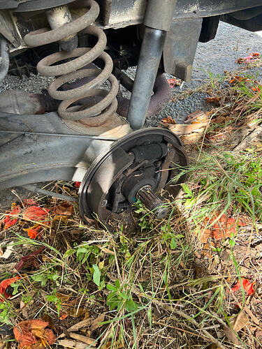

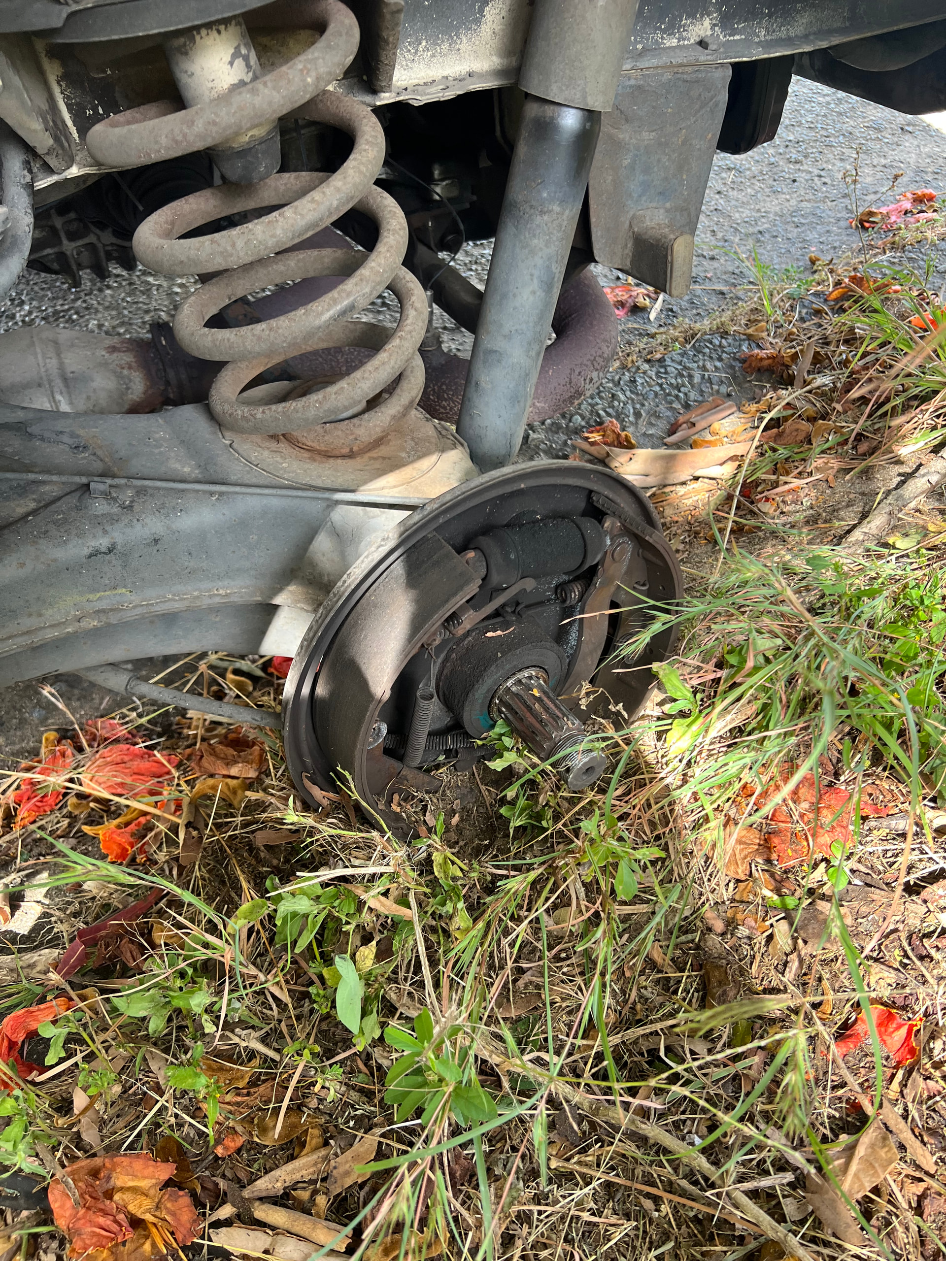

Hey guys,
A bit of a rough one today. Looks like my wheel hub has decided to come loose and fly off into the bush whilst driving. Managed to stop okay but geez that scared the life out of me. Still can’t find the wheel.
Can anyone recommend someone who specialises in wheel hubs or drivetrain to get a new one sorted and to give the rest of the van a good check over? Only tell tale was a noise that I assumed was a fan belt squeal. Not the case.
I bought the 89 Caravelle with the supercharged EJ20 conversion. I’m based in QLD too.
Cheers Rusty

That would have been scary, I assume that can only happen if the split pin had an issue allowing the nut to come off. Perhaps that nut wasn’t torqued to spec which should be about 490nm, I know because it can be hard to get off when you want them off.
Should be a simple repair once you have the bits. Cheers Uwe

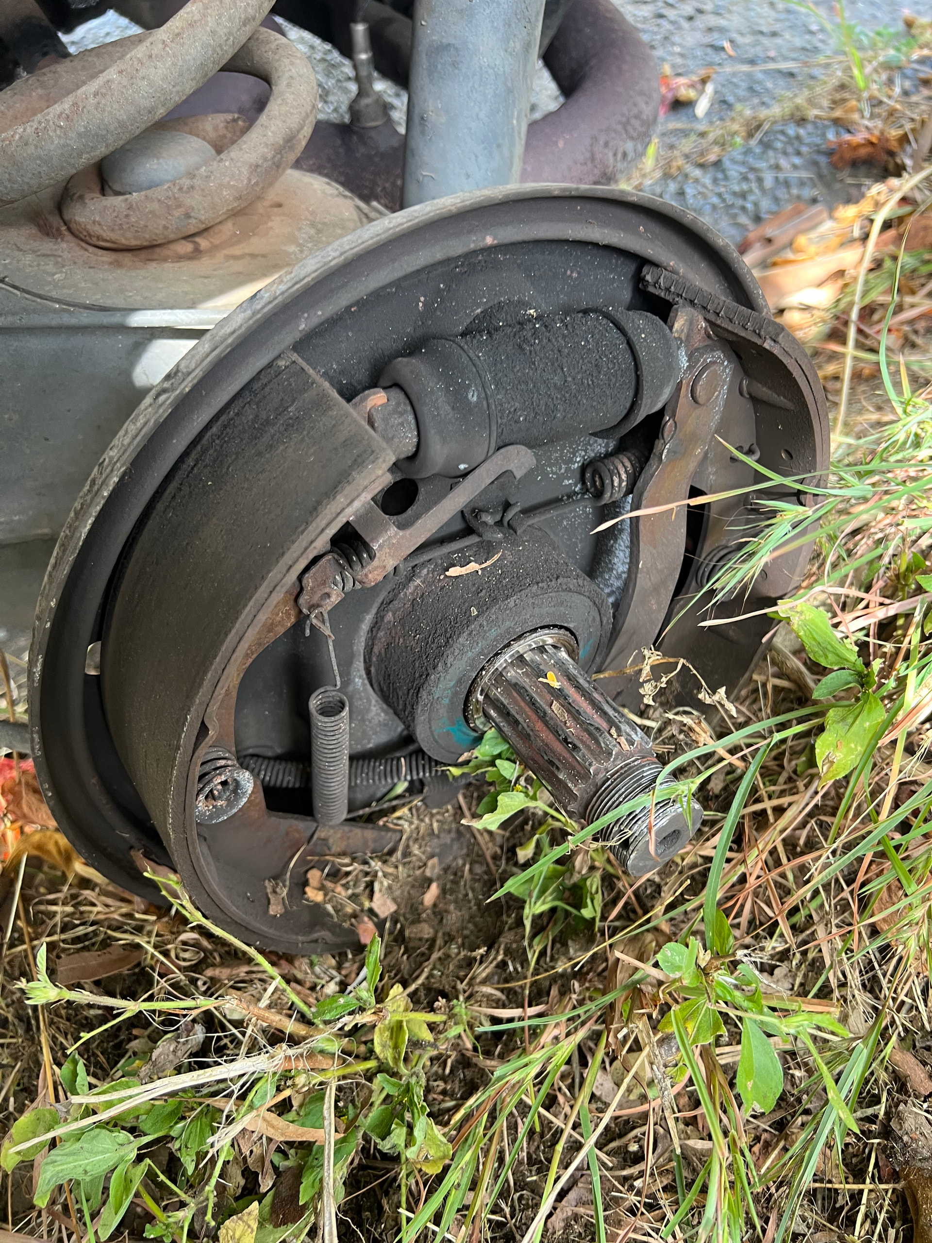

I’ve just ordered all the parts from Just Kampers. Is it a hard job getting the hubs back on? Any special tools?
Rusty
My mechanic has a torque multiplier on his torque wrench to get it up to spec.
They are extremely tight nearly 500Nm!
If you have some steel scaffold sections lying around, they can get the nut up to spec.
Leverage is your friend…

I’d certainly be checking for damage to the splines and thread of the axle before reassembling.
