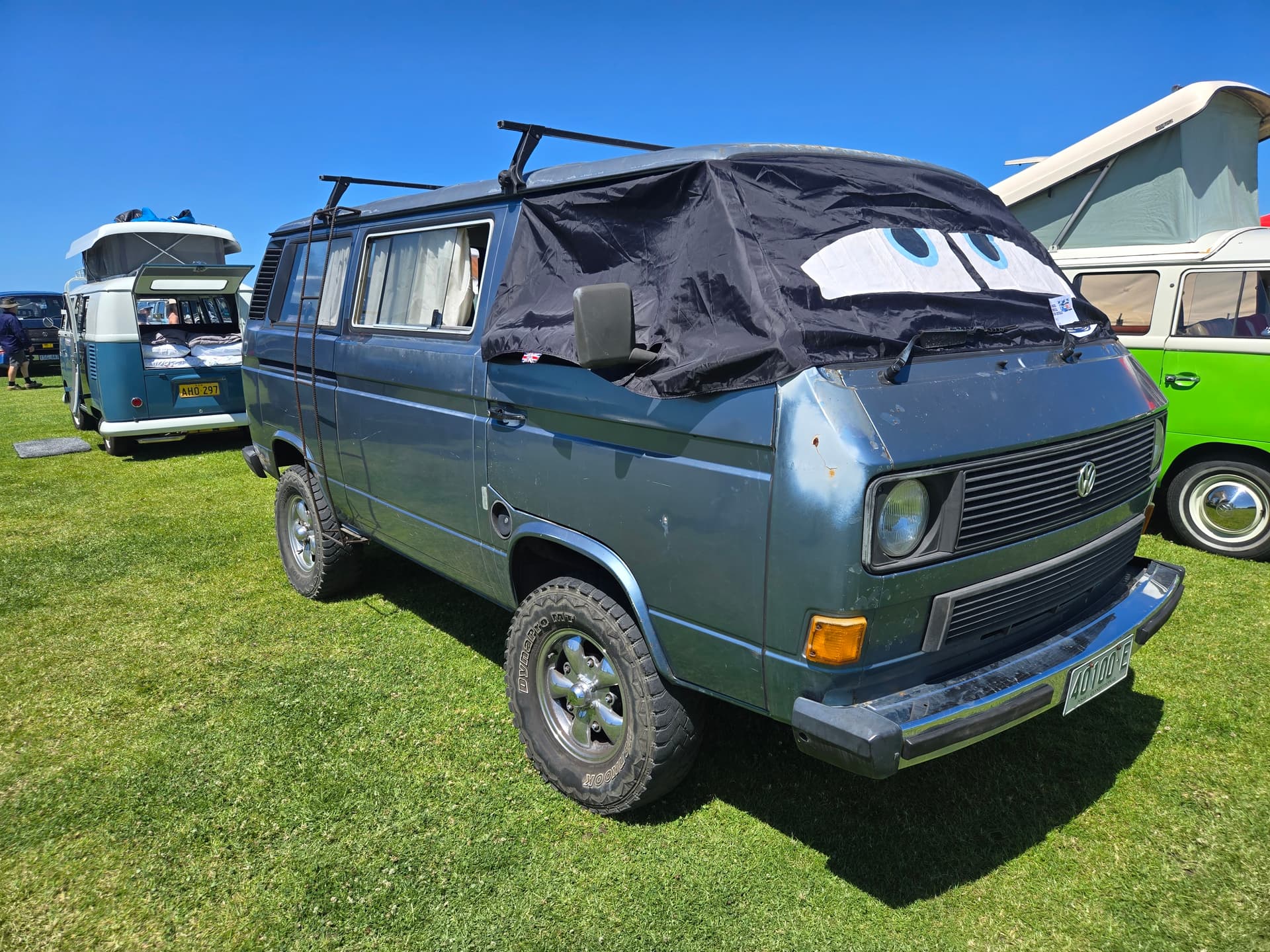

This dark blue one was all Subie drive-train with portal axles running wide 5 brakes from a Type 3 at the rear and adapters to the front on stock VW T3 brakes on the front. The portal axles are VW and designed to reverse the Subie transmission at the exles rather than at the back of the gearbiox as many are done.
He said he plans to get a Subie front diff and connect up so its basically an All Wheel Drive.
Very interesting van!
