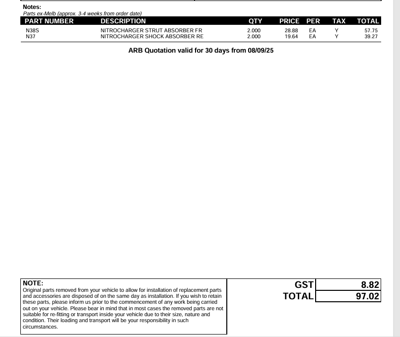

ARB selling T3 Old Man Emu Shocks front and back $97.02
Have to quote the part no as not listed online
3-4 Weeks delivered to Darwin all inclusive

Just ordered yesterday…a full set for $90.

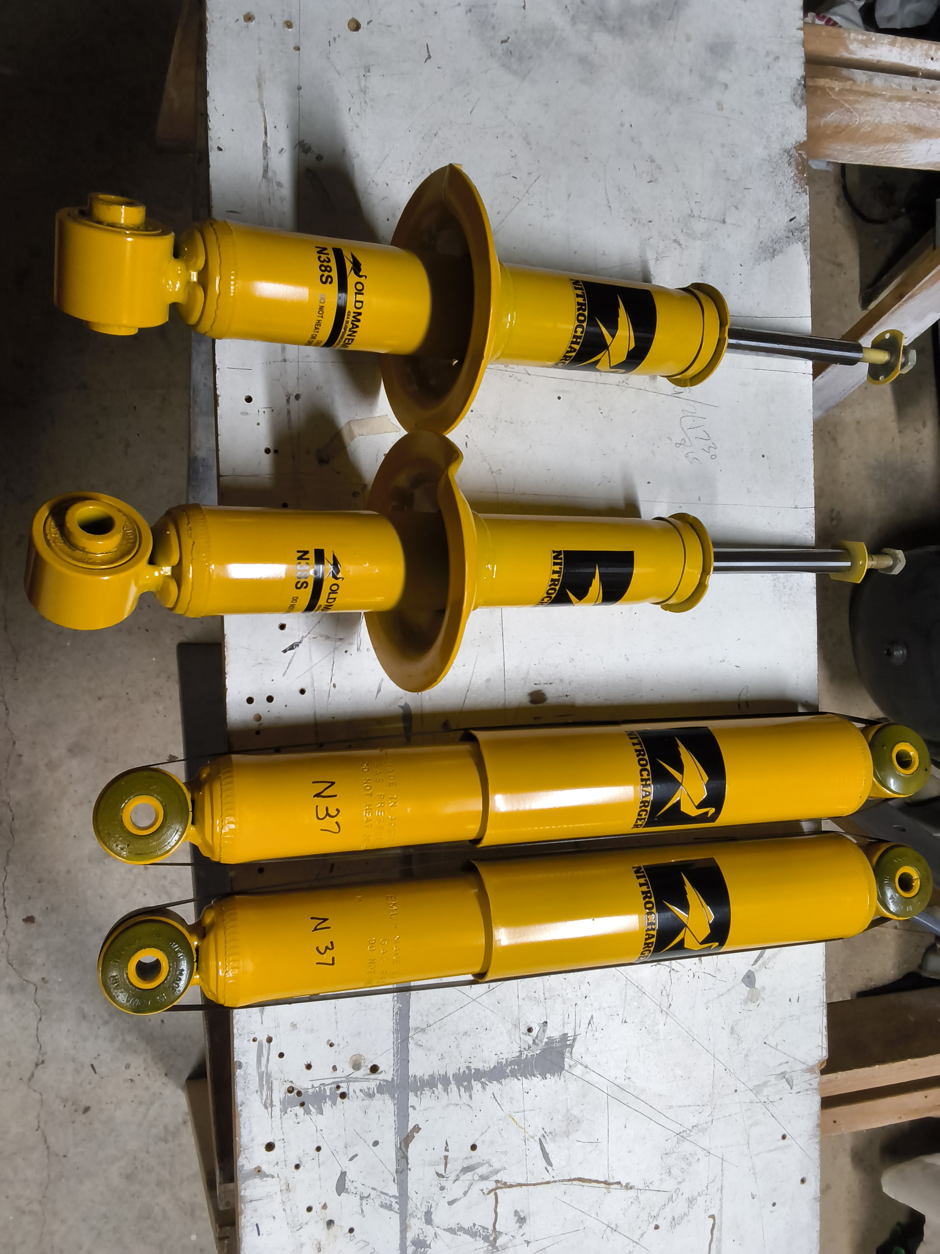

Here’s mine…picked up today.
$92
Nice - that was quick!

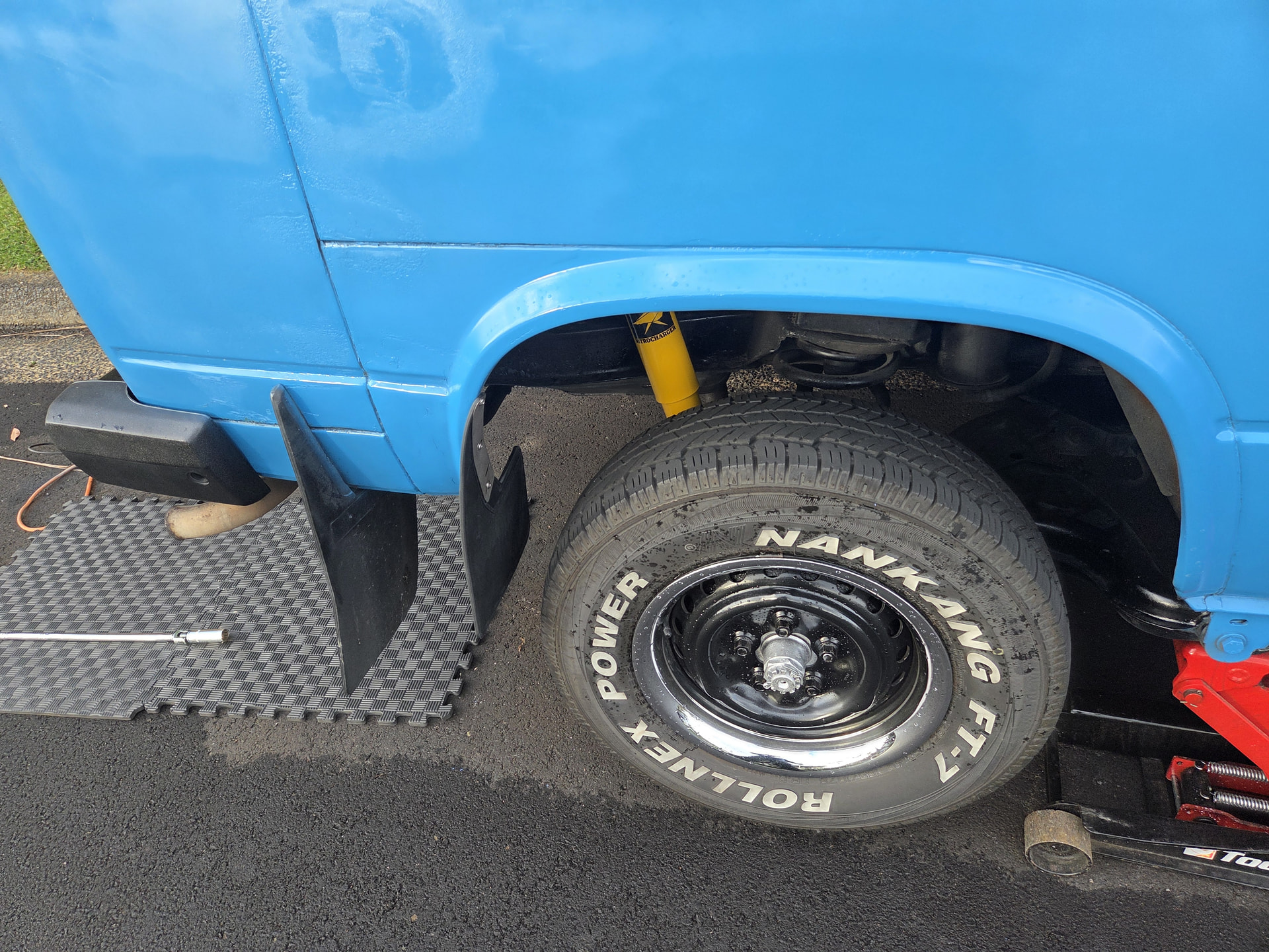

I installed the new OME rear shocks on the rally bus after removing the very old Koni shocks and the van handles much better and even sits better on the road.
A lot less rear suspension sag on acceleration from a standing start - especially up hill.
Very happy so far for $36 for the pair!

I’ve no looked if they fit well yet, but compared these with the Bilstiens I bought some time ago (on special)
Bilstein Shock Absorber - Syncro Rear | Van Cafe
The Old man Emu look much better built, much heavier and dampen a lot more.
They both have (almost) the same compressed and extended length, so am guessing they fit.

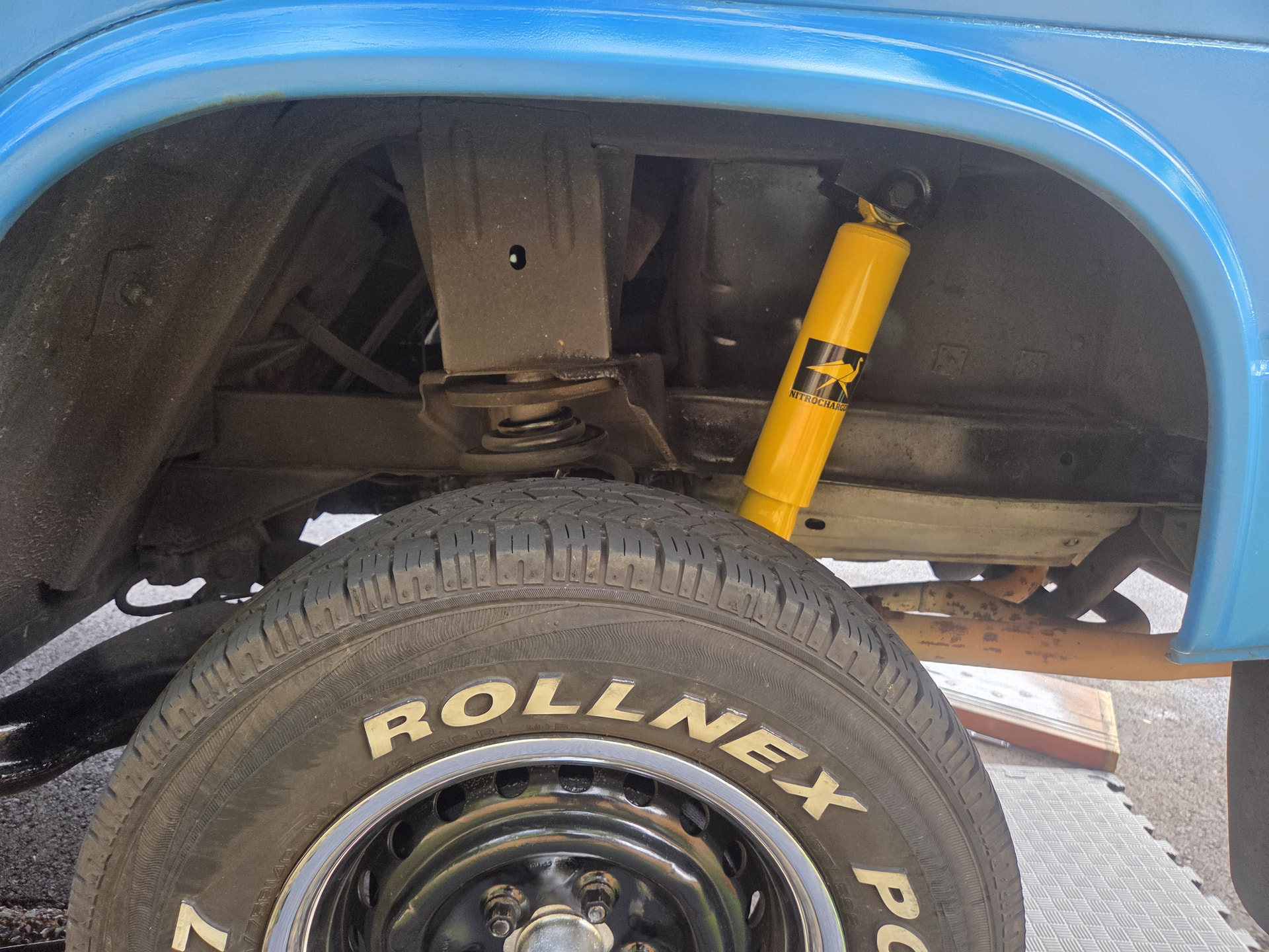

They fit great on a 2wd at least - not tried on my syncro as I have T3 technique rear shocks.
Nice. Is the swing arm down far enough for the spring to no longer contact th top plate in the second photo? The shock sets the max travel (extend), which would put a big angle on the CV’s for a 2WD as the gear box sits a lot higher.
Yes, the swing is fine.
Driven it over my kerb and a few mild off road adventures and it doesnt bottom out.
:slight_smile: Trying to out do the Syncro!
