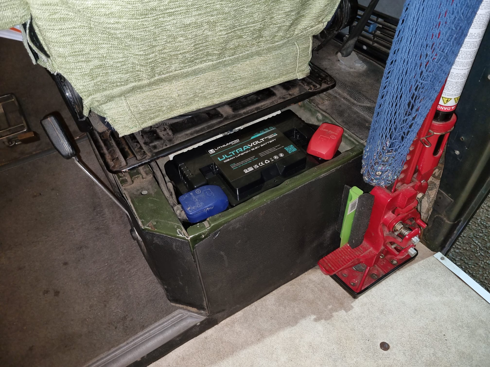

I have a 100A Lifepo battery under the passenger seat.
Mines a swivel seat so it sits higher than stock and this battery just fits.
See photo:

Oh wow that looks like the way to do it! Did you have to cut into that compartment? At a quick glance it doesn’t look like mine has been opened yet.

The only thing I did was remove the battery cover metal lid (which I had to do when installing the factory swivel seat).
That battery just fits and works well as its a dead useless space.

Yeah…wow…they look like a perfect fit!
Fits perfect indeed. This and the internal BMS were the reasons for choosing it.

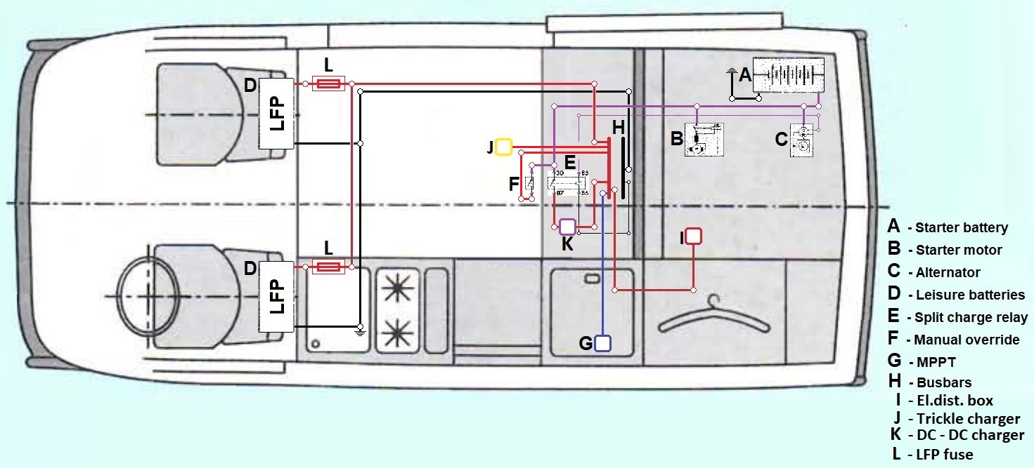

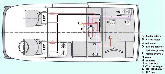

My Syncro is an ex. German army van, which had a 24 volt system onboard.
The stater battery in the engine bay as it is a turbo diesel.
The 24 volt system consisted of 2 under seat batteries connected in series. Modifying the connection to a parallel connection is easy, and the entire system is connected to the car using bus bars under the r&r bed.
The sketch shows the entire layout of the batteries, charging and manual override to enable cranking the engine if the starter battery is weak. The starter battery powers the starter motor only, and the rest of the car is powered of the leisure batteries.
That is very cool, and nice you have the circuit for it!
