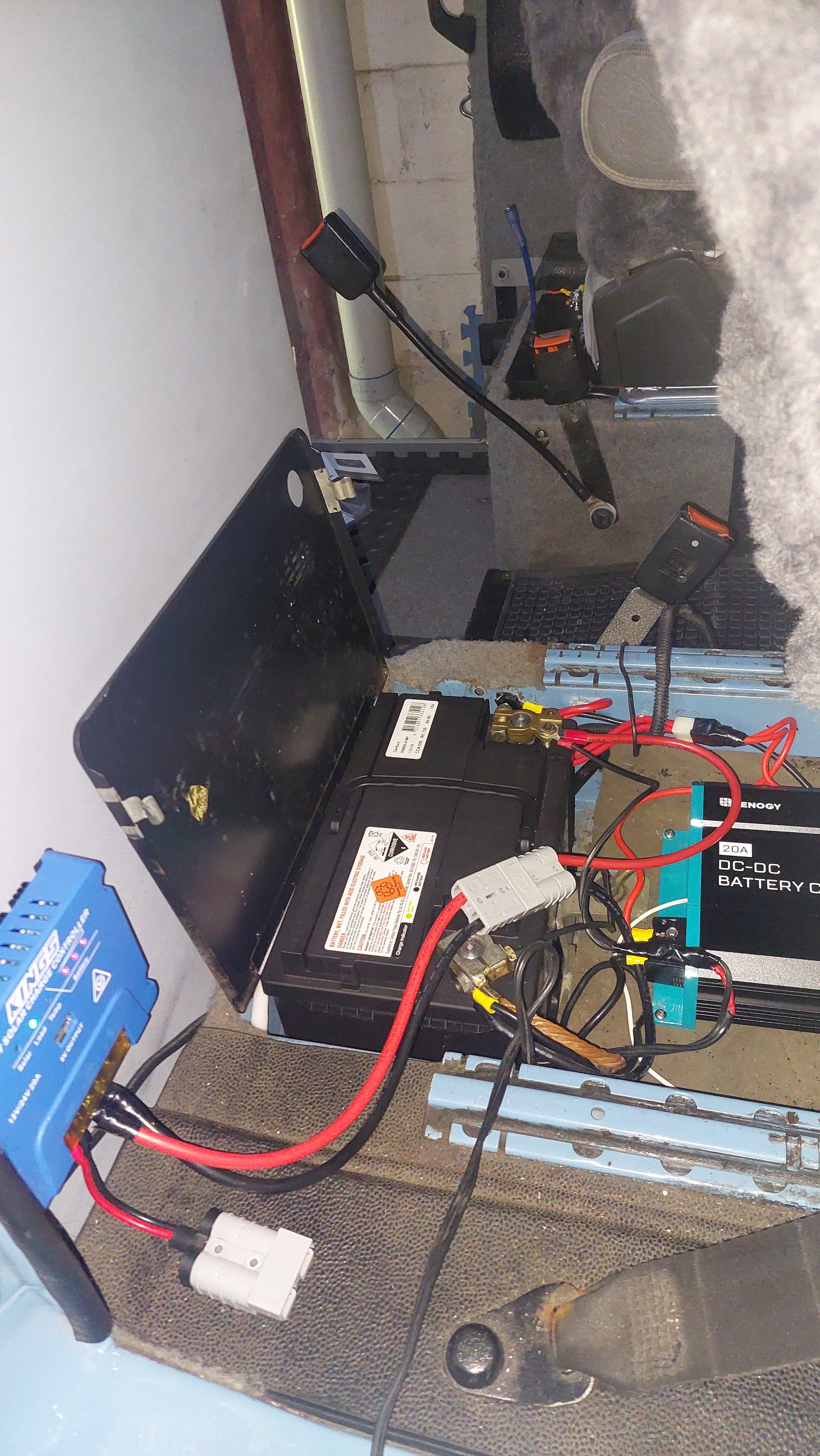

Hi Peter L,
I have done a similar thing to Peter C with the swivel passenger side seat which allows for additional height clearance for a house battery.
I had a Varta battery which cleared ok yet was only 60A/h and a lead acid so it didn’t last long when running my monster fridge after a cloudy day when the solar panel didn’t really do its job.
I have since upgraded my solar panel to a 200W foldable version and just upgraded the house battery to a Renogy 100A/h Lifepo battery which has yet to be tested camping. The great thing about these is you can put them to sleep like they are disconnected yet keep the terminals on. There is a plug in cable with a switch on it to turn the battery on - very easy.
Like Peter my solar is set up to charge my standard lead acid starter battery only and when I turn my van off the house battery is separated completely from the main battery via the Renogy DC DC charger. As soon as the ignition is switched on, the alternator will charge the house battery to its maximum voltage and then cut off charge until it drops again.
This is the thing - if you get a lithium battery, you really need a DC-DC charger or you might over charge and overheat the lithium battery which can cause damage to it.

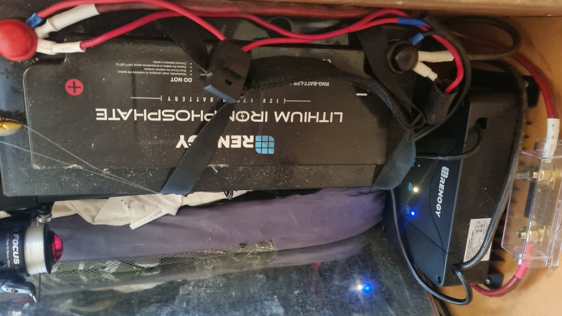

Hi guys. I went lithium as well. Renogy 170ah. I shouldn’t need solar. under the bed seat with their 50ah dcdc.
Seems to be the brand to go for. Decent value as well.
Does that 50 amp DC to DC charger cause any issues when the battery is flat? From what I have read lithium batteries will take as much power as you throw at them (so assume 50amps in your case).
Jon
Jon. I haven’t flattened the battery.
The dcdc I think is somehow limited if you have solar connected. But with 170ah in assuming it’ll last a while even without solar. We just have the basics, fridge lights, fan, water pump etc.
It’s never been below 13.2v. I don’t look at the amp draw.
