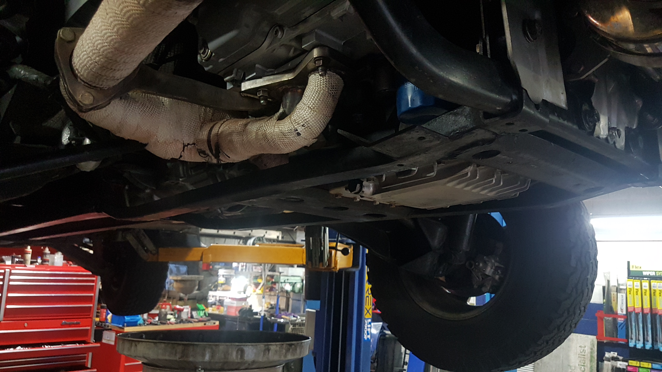

I did a gearbox oil change yesterday and had to remove the following to do it:
Sump protector (4 bolts)
Syncro skid plate (6 bolts)
Exhaust (6 nuts)
Selector coupling (2 bolts/nuts)
What should be a 5 minute job took an hour!
Painful…

Certainly a good one to check Michael, I did mine a couple of years ago now.
Why the exhaust Scott? I assume the Subie exhaust is in the way? I can change the oil with only removing the fill and drain plug, but yes it’s a pain! I have yet ot finish setting it up, but have a small oil pump I can use to pump oil into the GB to avoid removing anything from the fill plug (I have a small tube bent up to feed in). The plan is I can drop the oil regularly and run it through a filter to keep the oil clean.
One day…
My Smallcar exhaust runs between the engine and gearbox and tucks up really well for clearance reasons.
Whilst you can get to the sump bolt you cant actually get it all the way out and hence the exhaust needs to be dropped a bit and to do that I also needed to drop the syncro skid frame a bit to allow for it.
Always good to check things out while its up on a hoist…
