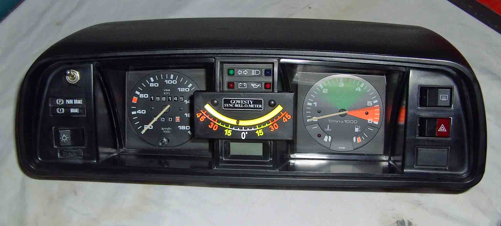

Reviving the topic “Syncro Speedo”, I don’t recall ever reading a question nor an authoritative answer to the following:
Why is it so and what purpose does it serve that on the syncro speedo dial, between the 50 & 55 kmph markers, this space ONLY is coloured?
Ken, 50km/h is the speed limit within cities and urban/build up areas throughout Europe.
That indicator on the speedo is to make it easier to identify your speed within those areas
Thanks for that clarification, you win the prize for a first time answer to a first time question. Well done Arne!
Meaning we got here a European speedo, that 50-55 marker serves no legal purpose in OZtralia that I’m aware of.
Interesting then that the instrument cluster in the pic, I purchased from USA. The MPH speedo that came in it had NO similar coloured marker anywhere on its dial. Cheers. Ken
Maybe it was for thought of the importers that we would one day introduce 50khp in built up areas :slight_smile:
Plenty of 50 kph areas in Port Macquarie. Makes no difference to the P players of course. Peter
