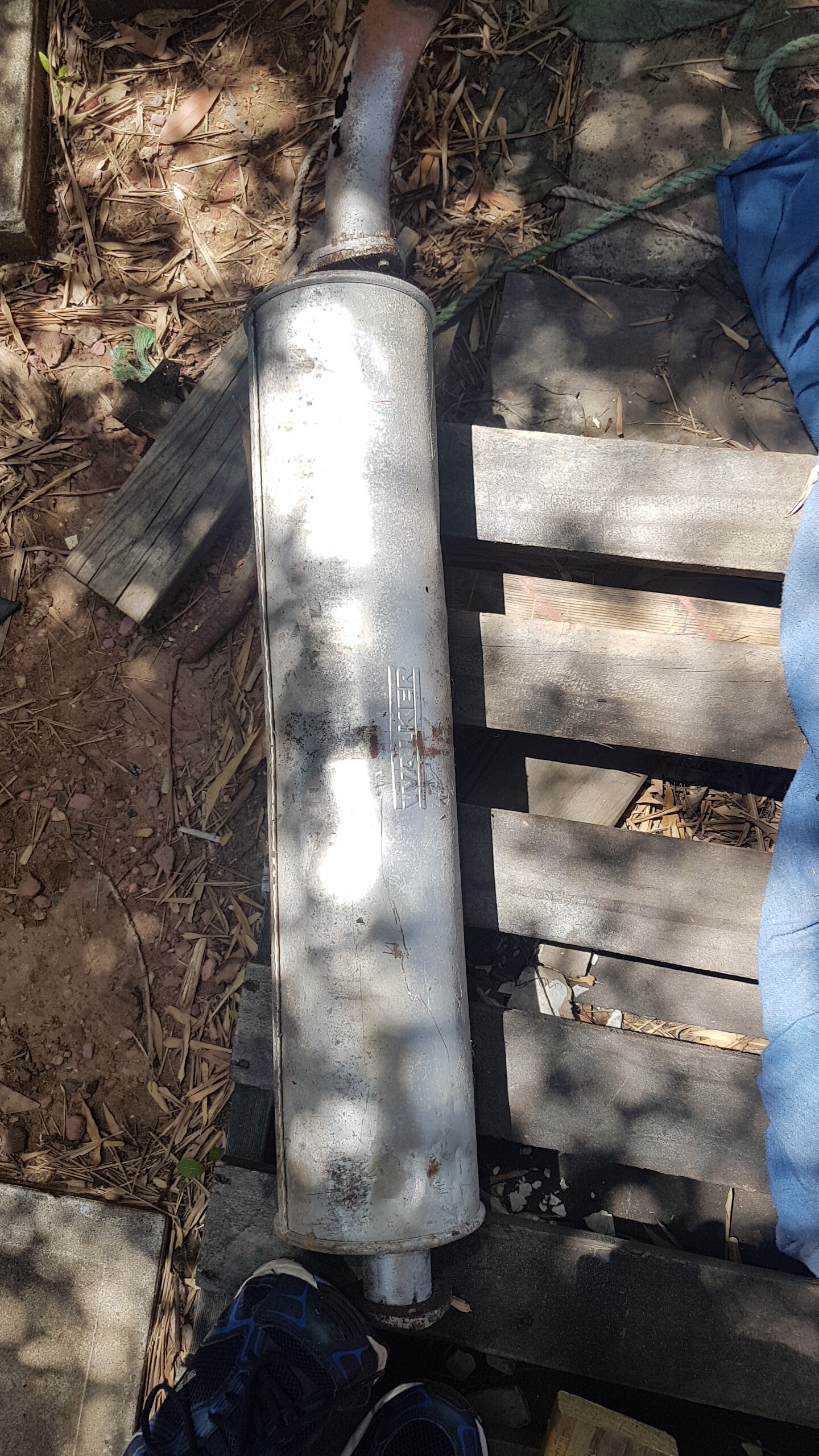

I have a 2wd standard muffler made by Walker which came off a motor that I have parted out a while back.
The outer casing seems good but the inner bits seem loose and mushy and the tail pipe bolted to it is rusty and off a 2wd so would need to be replaced.
Its all yours if you want to come and get it - too bulky to post.

I might cut this one up and see what mess lies inside. Wont fit in the bin in full length with tailpipe.

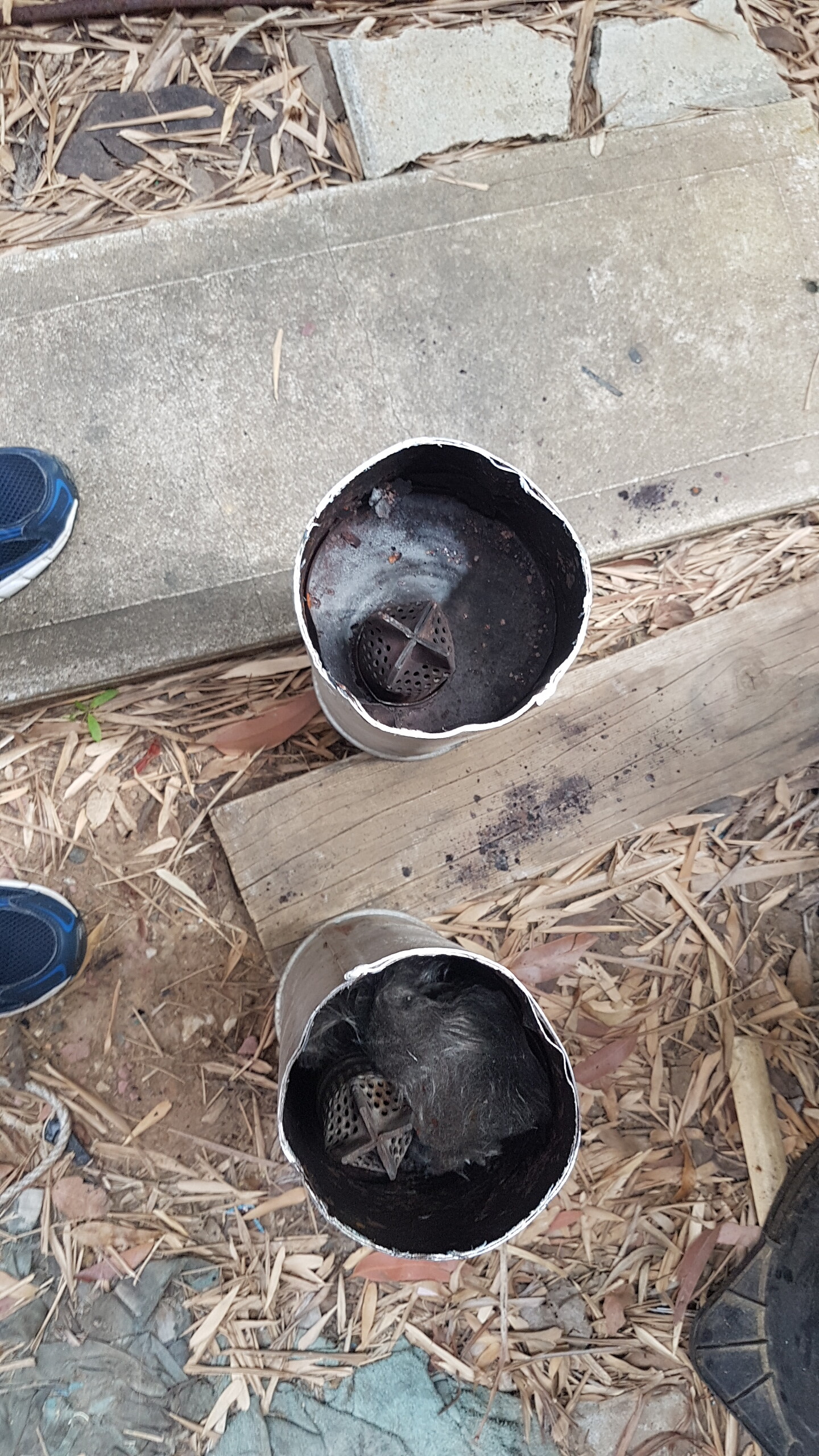

I cut open my spare muffler today and it is an interesting thing - has an oversized flute in the middle with bracing sections and a glass fiber wool in the exit half of the muffler around more of the flute. Everything was loose and easily removed from the outer casing once cut in half.

I got the grinder out the other day on my old unwanted T3 stock muffler and cut it in half for 2 reasons:
  1. I wanted to see why the contents were so loose and
  2. So it would better fit in the bin.
This is the result before and after.
It seems to have a single flute style metal pipe in the centre which is spaced by the loose rings and its stuffed with glass wool.
Not really any rust just poorly constructed
by Walker Exhausts.
