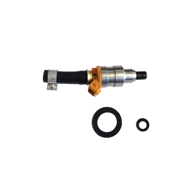

Reviving post above about fuel injectors, given recent query about source of replacements. May be of interest to some about the VW 20F3 recall.
Seems not all usual VW part suppliers stock T3 fuel injectors, or are out of stock, but a few example links:

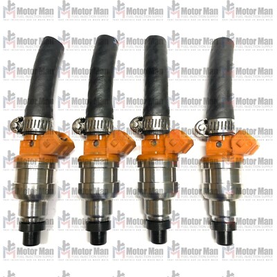

Every now and then a replacement full set of re-call injectors pops up for sale.
Some people got them as a recall I have been told yet never fitted them and kept them for a rainy day that never happened.
Worth buying if you can get them before anyone else jumps on them…

I’d be interested to see an “entitled” T3 van that DOES have in place the 20F3 recall sticker on its driver side “A” pillar, but remarkably does not have installed the newer correct coloured fuel injectors, replaced new fuel lines & sleeves and associated new fuel line connections. :open_mouth:

However a mate of mine has managed to buy two sets of brand new never fitted fuel lines and injectors which were packaged up in a kit for recall install from people that managed to acquire them but not fit them.
The last lot cost hm $450 but worth it if you can get them - especially with that fuel line eating E10 floating around in some peoples fuel tanks.
I have seen a few of these kits for sale over the years.
