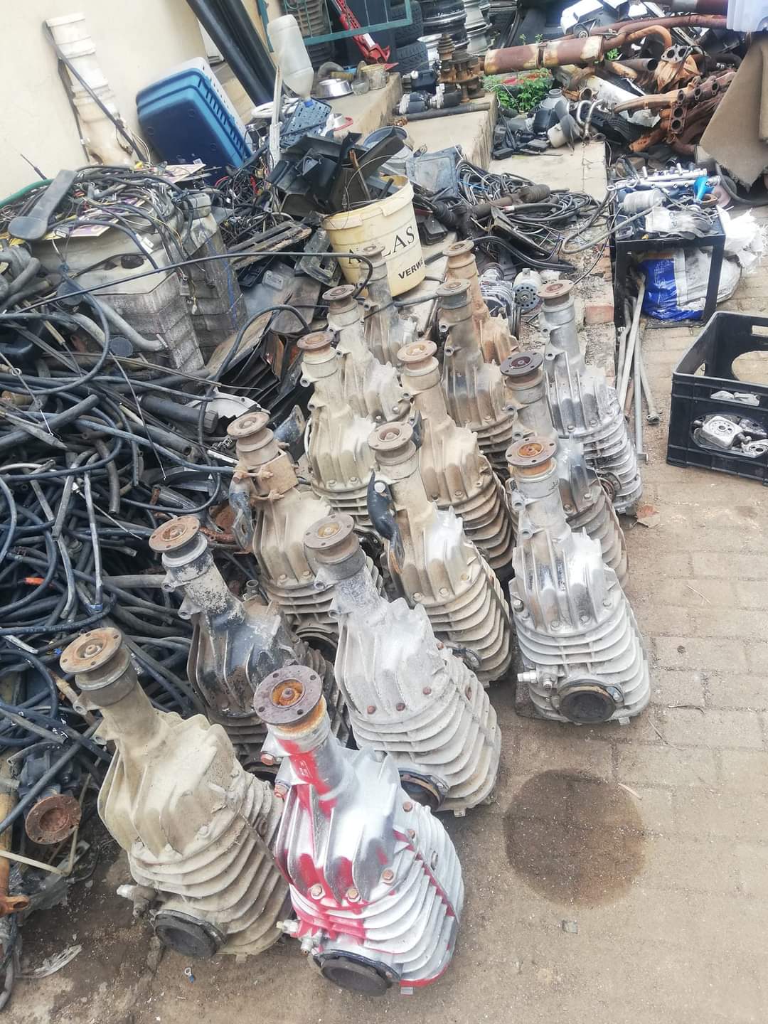

Richard, I see syncro hospital in South Africa is doing a cleanup, lots of front diffs with lockers.
From the VW syncro Facebook group today -
“Started to tidy up a bit this week… 5.43 locker diffs for T3 syncro…”
I agree shorter wheelbase and higher ground clearance essential for real off road travelling. For better traction I dumped the VC for a solid shaft and installed a decoupler and Peloquin diffs front and rear (rear diff lock already existed in my Syncro). Chose to go front Peloquin diff instead of front diff lock because the Peloquin allows full steering and is about 70 to 80 per cent that of a diff lock - works brilliantly. If I can’t move about with all this set up then I would declare myself silly for being in such a predicament.
They do look enticing I agree but Stuart Stirling advised me that shipping is a killer from South Africa to anywhere in the world at the moment.
And can assure you there is no turning once that front locker is engaged :sweat_smile:
Maybe we need a group buy on gear boxes and diff’s :slight_smile:
Nil’s, if your that stuck that you need to engage the front diff lock, any forward motion straight or otherwise will be helpful. Last ditch attempt before you need a shovel and winch.
Is 5.43 what we have here as standard? (14" syncro)
Yes I believe it is. There used to be a spreadsheet knocking around with all the codes and ratios.
