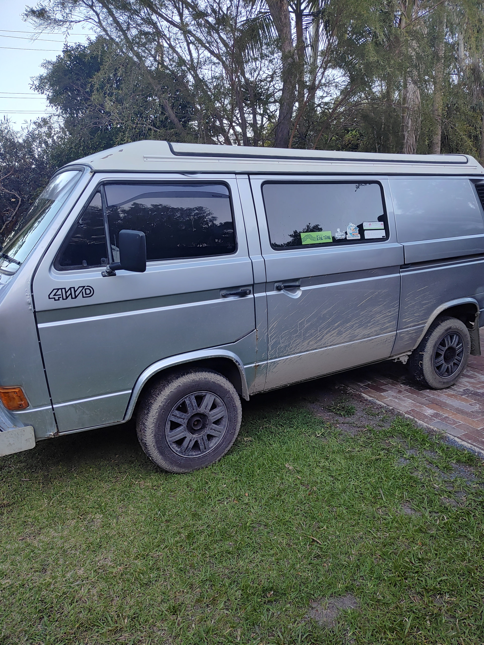

Anyone know of wheels/tires for sale? My tires are up for replacement (running 215/75R15) which I’m happy with. My old Merc rims need replacing also.

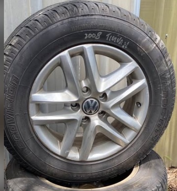

Before I go looking around, wondering if anyone had anything for sale? I do have 4 Tiguan rims I’ve never fitted, so could fit 16" tires onto these rims.
Looking for something for off road use, if I’m not going off road, I usually put the stock rims back on (with commercial rated tires on)

Those Tiguan rims are popular, yet I don’t know their offset and whether anything is required to the centre bore or the hole size?

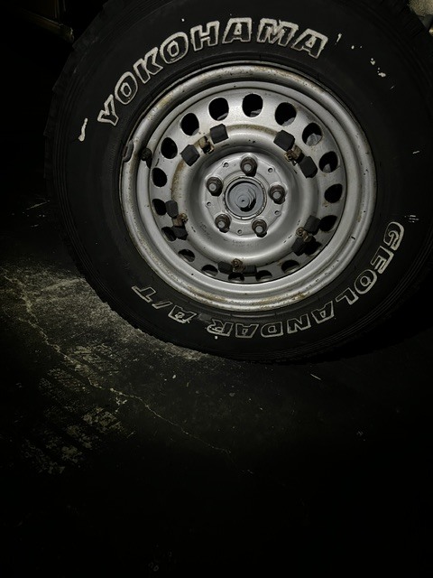

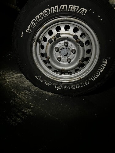

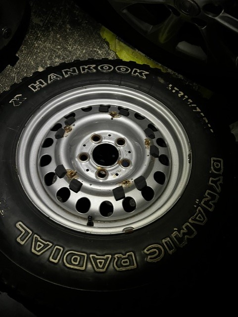

I’m still running my old Merc rims (off my T2), 215/75R15. The Yokohama’s are on currently, the Hankook are the old tires (I carry as an extra spare). The Hankook were actually nice tires, but not available when I got a flat.
They are the wrong offset though, so need new rims also. They do fit fine with no modification other than the (stock VW) wheel nuts have a different radius to the Merc rims, so I re-shaped the rim to fit.
I picked these rims up ages ago, and like the face they are 16". If nothing else comes up, I’ll use these.
Scott, yes these need a small chamfer on the inside edge of the centre hole to fit on the front. Have not check stud lengths yet (but do have the correct wheel nuts for them)
The are ET33, so not an exact fit.
