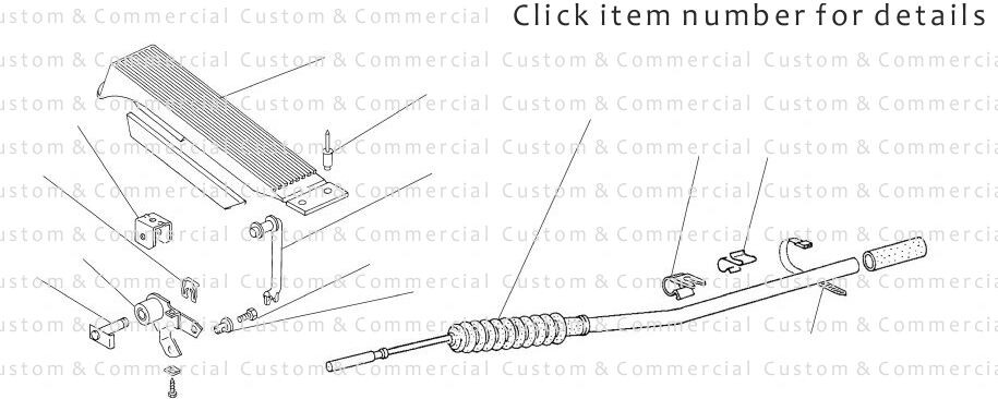

For those wanting to understand the different cables out there for  T3 variants, see the the attached ETKA schematic and parts list. It also shows the cable lengths of each variant cable.
Also see the other attached pics that may be helpful. The part number stamped on the black cable shroud of the first pic was on the correct cable, the latter pic shows the part number on the black cable shroud for the incorrectly supplied cable. Those black cable shrouds were also different in length.

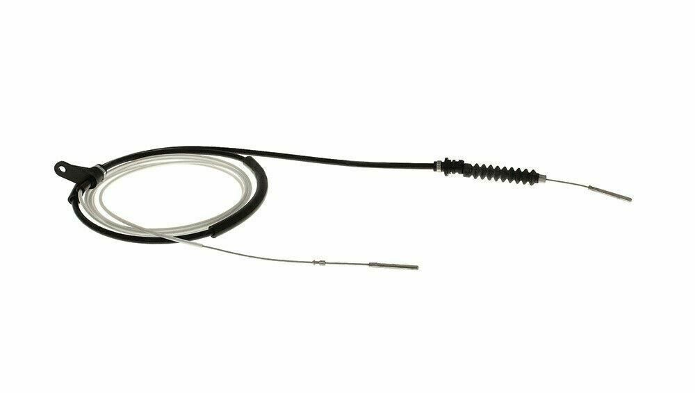

Compare the correct GEMO replacement accelerator cable you’ve installed and/or have a spare of, with Scott’s supplied schematic. What do you see on one and not the other?

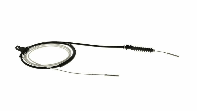

Are you referring to this 1982 -1992 RHD accelerator cable by Gemo?
Without a part number, looks about right.

Ken are you referring to the lack of barb to the end of the accelerator cable compared to the schematic?

Looking through my box of bits a while ago, I did end up with a LHD spare cable. in a pinch it would not be difficult to adapt for RHD use (just one section is longer).
