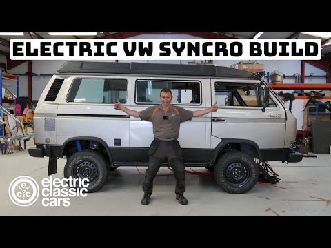

This is something we may all need to do to keep our syncros on the road unfortunately…
Very interesting Scott…though with all the room taken up with those batteries I can’t see where you’d cook, sit and sleep.
Agree, its a massive compromise and there is a again the danger of fire during charging which is very high in these vehicles.
There have been quite a few that have burnt to the ground whilst charging and I’m sure they would cost a lot to charge and considerably more to replace the batteries at the end of their lifespan (which doesn’t appear to be long)…

Interesting, on my Syncro quest I contacted one of the Australian EV conversion companies and the ceo said a Syncro was his dream conversion, mine too. This will happen in Australia soon enough I think as long as a few stay structurally sound to make it a worthwhile project. Quiet a few other VW models have been converted in WA. Watch this space.
I wonder if it’s practical on a Syncro to have two motors, one front and one rear. With electronics you can split the torque nd have constant 4WD and reduce the load on the rear diff.
Maybe even four motors like Tesla use on their SUV model.
They have massive power and traction.
Yes 4 motors would make sense, no differentials or gear boxes, no diff locks or VC’s needed any more, just some smart electronics and off you go.

I actually love the idea of keeping the Syncro drivetrain and simply swap the motor.
I can see the heating / AC is a bit of work, and some cooling for the electric motor.
But in terms of batteries, I would just have one pack replacing the fuel tank space and maybe another in my unused spare tyre well, and then for long range have a trailer to carry as much or as little as needed. That way the entire inner space can be kept as was.
Just wondering on the vacuum system for the brakes and the diff locks?
Where do you get a vacuum system from when you only have an electric motor?
Do they run a separate pump like they will need to for the A/C and the power steering?
Loads of issues to think about in the electric conversion of these old tanks!

Electric for vacuum should not be hard to generate, and power steer/AC would have to be common in electric cars today.
Just wondering why you’d keep the Syncro GB? Two diff’s and two electric motors would make more sense? But I guess a whole lot more to instal and control.
120kw, and no decoupler!!
Agree the decoupler is an odd thing.
I think the gearbox/ front diff wouldn’t mind the smoother power delivery from the electric motor - which would help cope with the power and torque of the electric motor.
