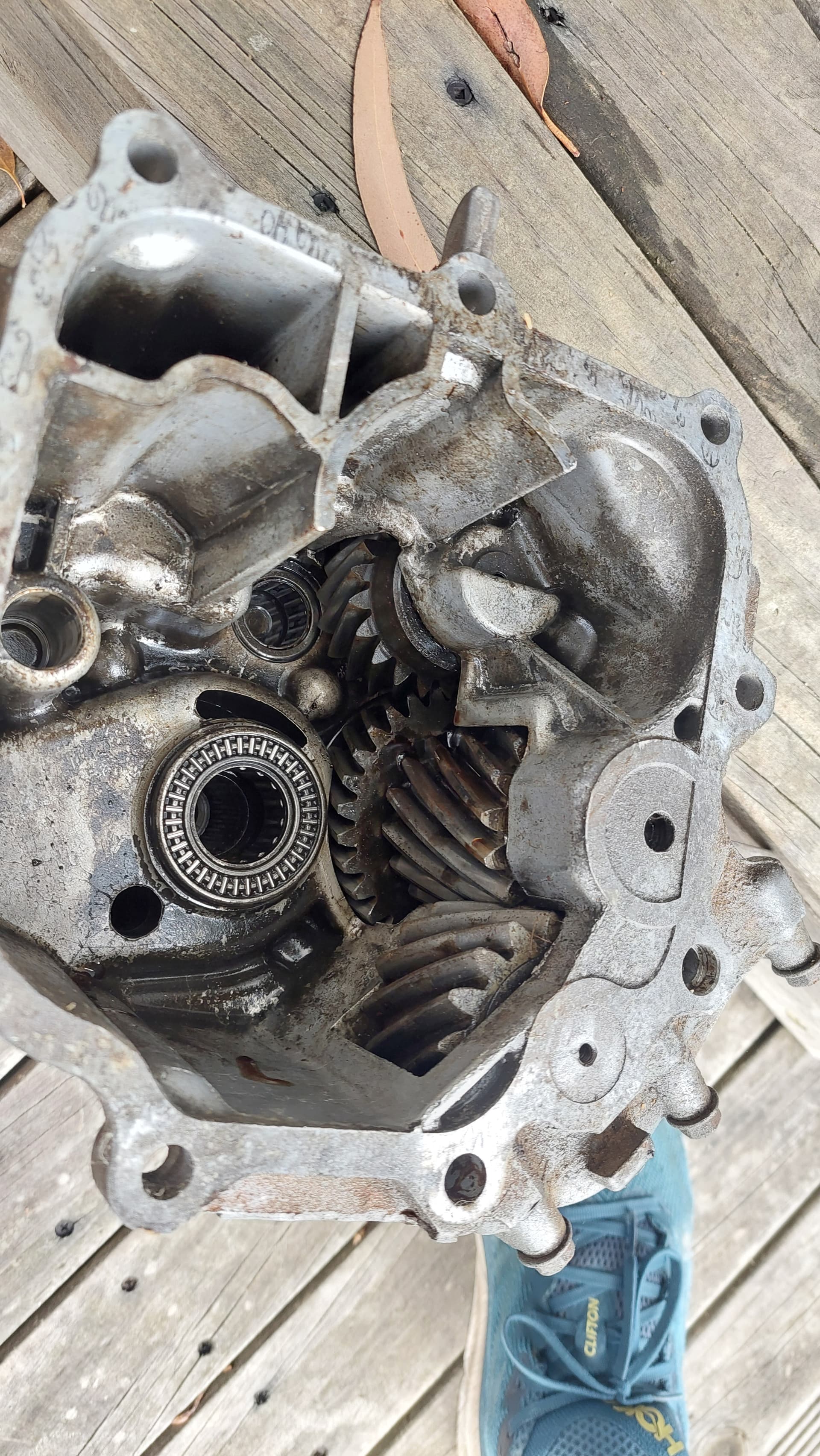

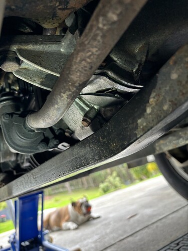

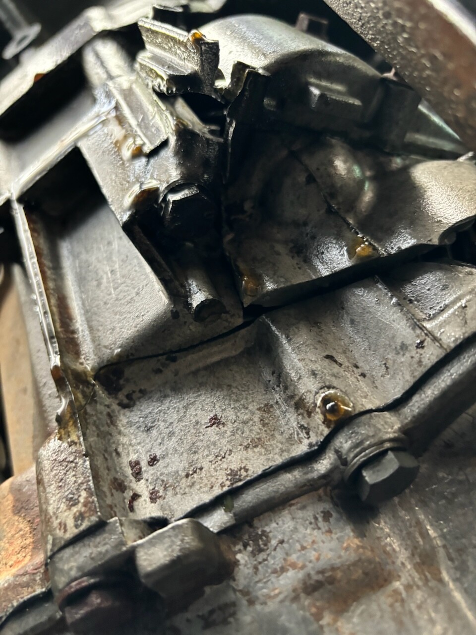

This issue has popped up again and I thought it would be advisable to send out a reminder warning to syncro folks to never clutch start your van in reverse.
A local syncro owner Sam tried this in his syncro and found out the hard way as his battery was flat.
He managed to rip a hole in the side of the gearbox where the reverse idler is located.
An expensive fix would have occurred if I didn’t have a spare section of a transmission.
Check out the damage:
