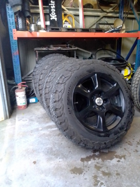

Sorry for the delay Gaetan. See picture. It’s a set of 5, they are powder coated black, 2011 Audi A4 rims, 16" x 7" , ET40 (only 4 are powder coated). They were on a '92 Syncro with no issues. 4 x BFG K02 tires are used ~90% tread, the spare is unused. 215/65R16, so close to stock diameter.
He’s after $850 for the set. Comes with nuts and center caps with VW on them.
If your interested, I’ll send you his phone number. If you need them shipped, I can see what I can organize from work.
I dont think the photo has come through.
I certainly cant see it?
Anyway - maybe send the photo again.
Thanks Scott, let me know if you can see it this time?
Yes definitely works now.
yes I’m interested - just what I was looking for really!
